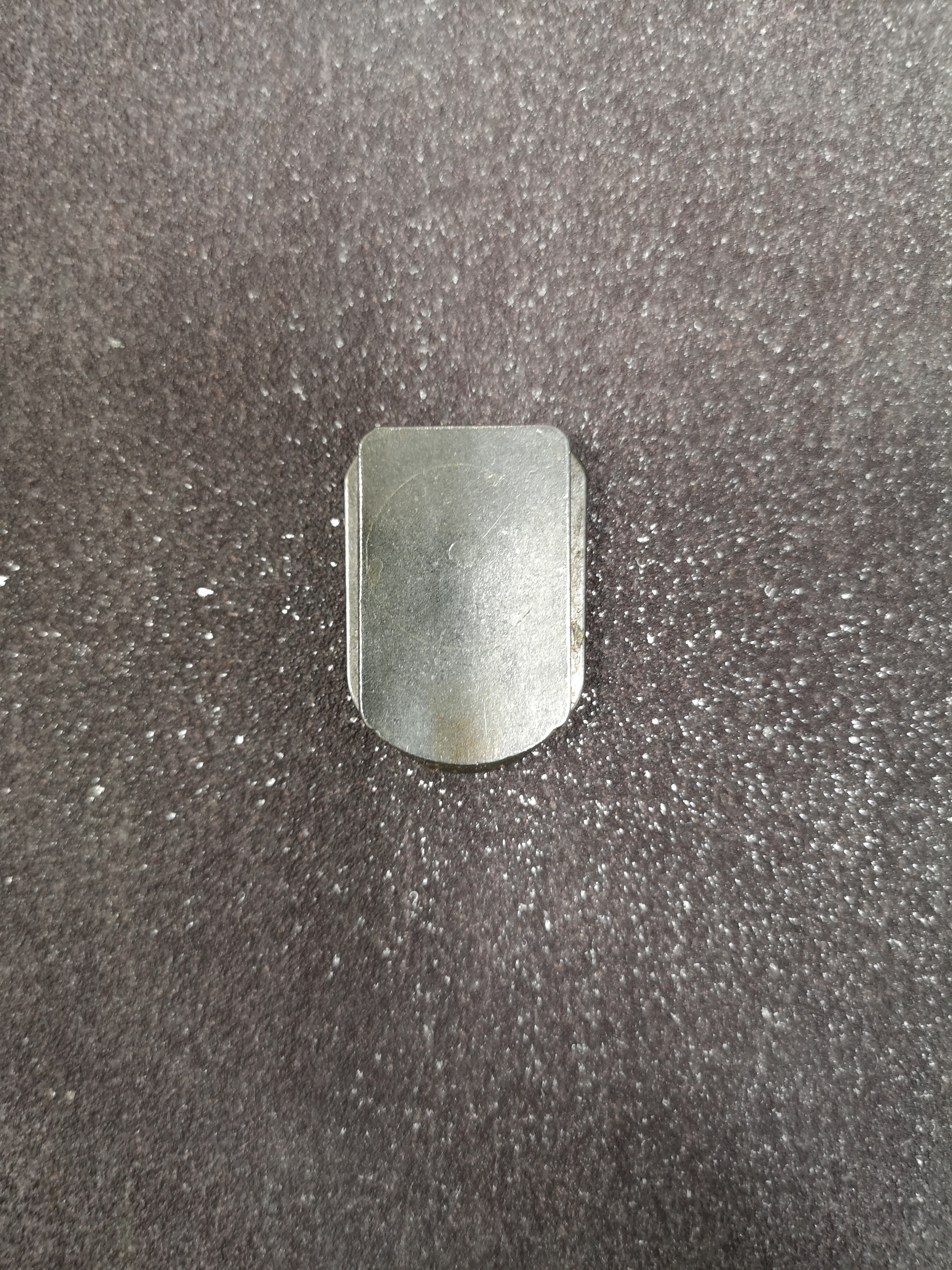

Got tired of the rear view mirror falling off every time it got hot, and took the mirror button to work so I could sandblast it.
The glue should stick a little better now...

What glue do you recommend? I've been using Loctite and if I'm lucky the mirror stays on for a few months. One of my cars, I actually scuffed a spot on the glass itself with some light sandpaper. I think the heat has a lot more to do with it than the glue itself.
