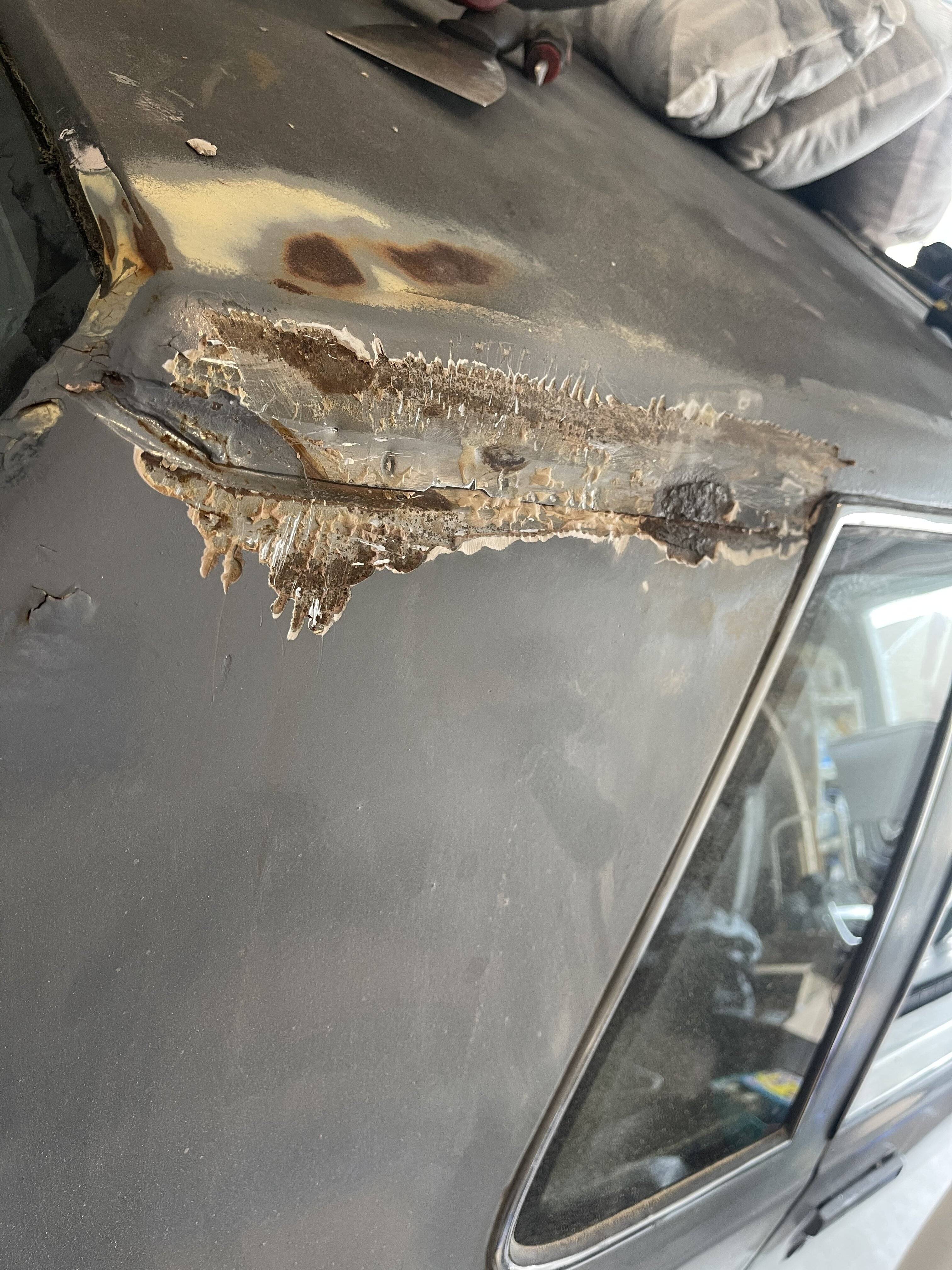

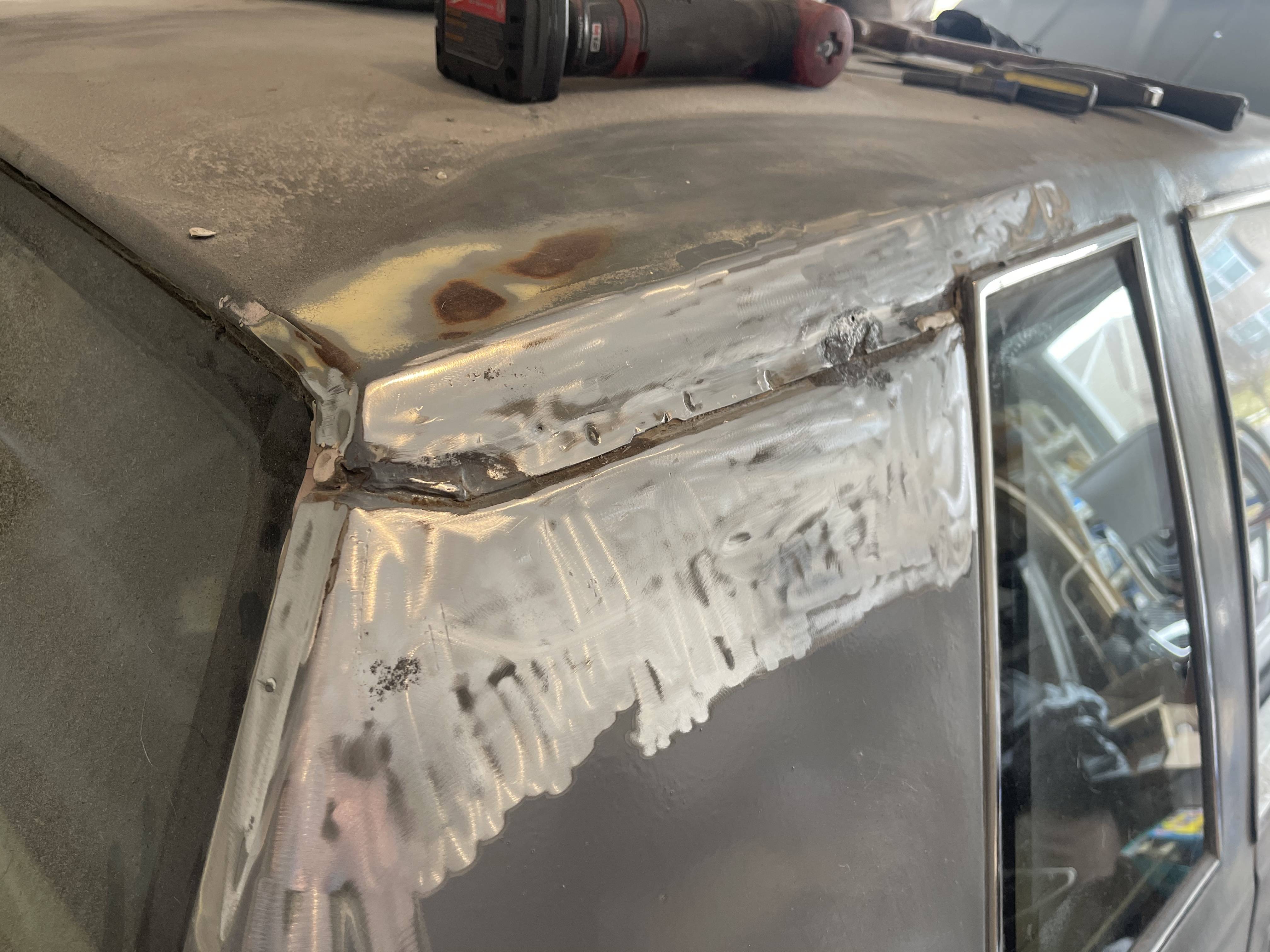

Pulled off some of the bondo the PO put on it. There was some rust coming through it. Going to pick up some rust converter. I really wanna try to have my rustoleum paint job done soon. I’m tied of looking at it the way it is.
Looks good so far...is it a hard top or vinyl? Throw some tiger hair in the seam before you finish it out with body filler it is moisture resistant. I've used the plastic lead they make for the seam but wasn't impressed. When I got into bodywork 35 years ago the bodymen used to put in real lead. The next time I do it I will use 3M panel bond. I used it to glue the loose wings on my 84' Hurst trunk spoiler...it was put together with body filler before the previous paint job from 22 years ago...lol.
It was a vinyl. I’m probably going to weld a plate like motorheadmike did. Haven’t decided yet. I’ll look into the tiger hair as well.
