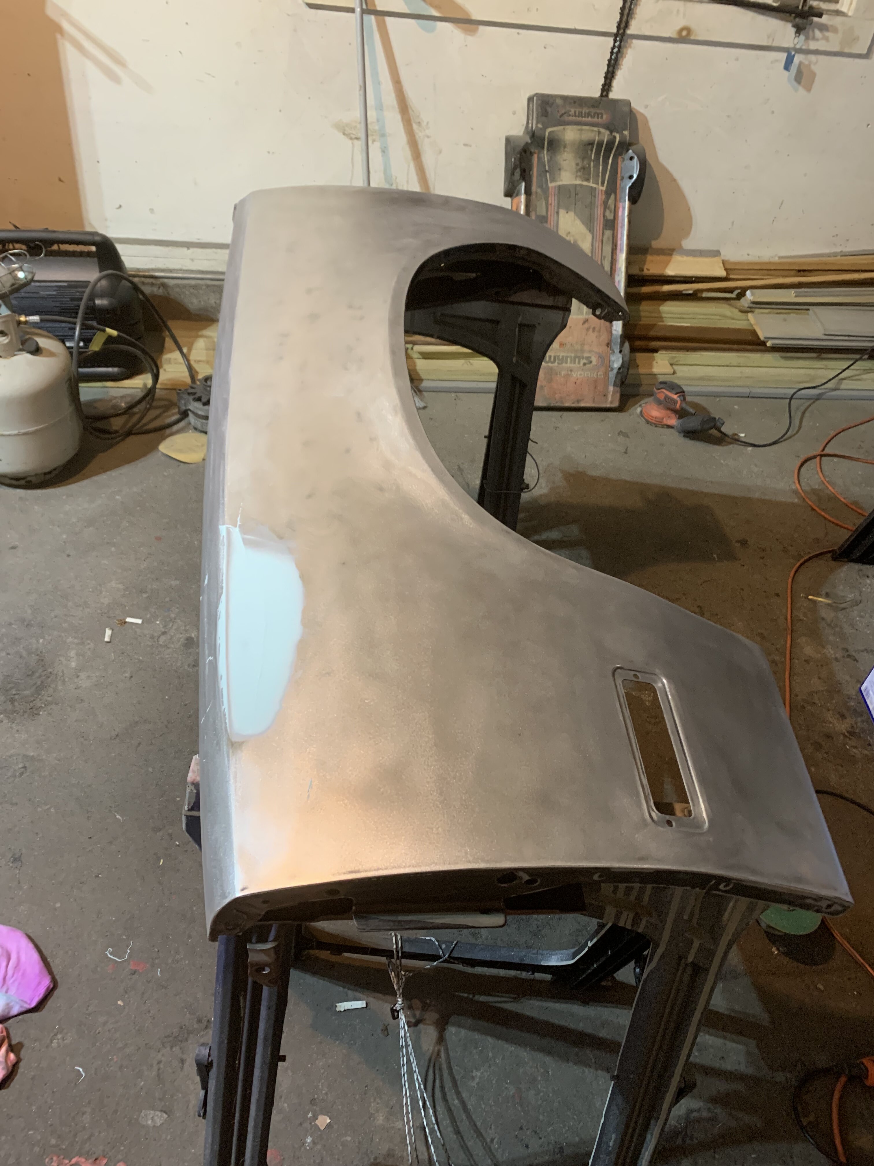

At long last we got started on getting the body of my ‘80 ready for paint. Started on the front fenders. Got the left front completely stripped as it was off another car and was not refinished well. It had one low spot that needed a skim of filler. Used Rage filler and will be using Nason paint products as they are easily attainable locally. In the end it will get painted in single stage urethane metallic maroon it came with. Was pretty pleased with the first nights progress, I’m learning as we go so it may be a little slow going until I’m up to speed. The passenger fender is original and should not need a complete strip to metal as the OEM paint has held up pretty well and has never been hit. My friend will make the call when we get started on it.

Made some progress tonight but took a set back as well. Years ago as a young man I was a little over zealous merging onto a busy road and the guy in front whom I though was already gone was in fact stopped in front of me. I hit the brakes and the Olds nose dived and went under the guys K-Car. No damage to him and he left, I was left with a popped header panel that needed to be replaced. I bought a new one and had a local shop paint it and I installed it back onto the car. What we found tonight was the fender took on a little damage from the hit that I never noticed. So next work night I need to bring the header panel with me so we can see what it looks like and how to repair it. For tonight we got the inside of the fenders painted semi gloss black so it’ll look nice when I open the hood up. I sprayed up and into the inside of the fenders just to cover it up and keep whatever dust may be lurking there encapsulated.

Curious as to why you chose single stage? BC/CC is a lot more forgiving, and generally holds up better in the long term.
FWIW, I would strip it all, especially if it's lacquer

I'm the oddball that misses lacquer paint. It had character. Plus, when it went downhill you didn't need to strip to bare metal to fix it, aside from the checking, which, in itself was character too.
You could do a lot more to bring back lacquer painted cars that sat forever than a base clear.
Everything has its advantages and disadvantages.
