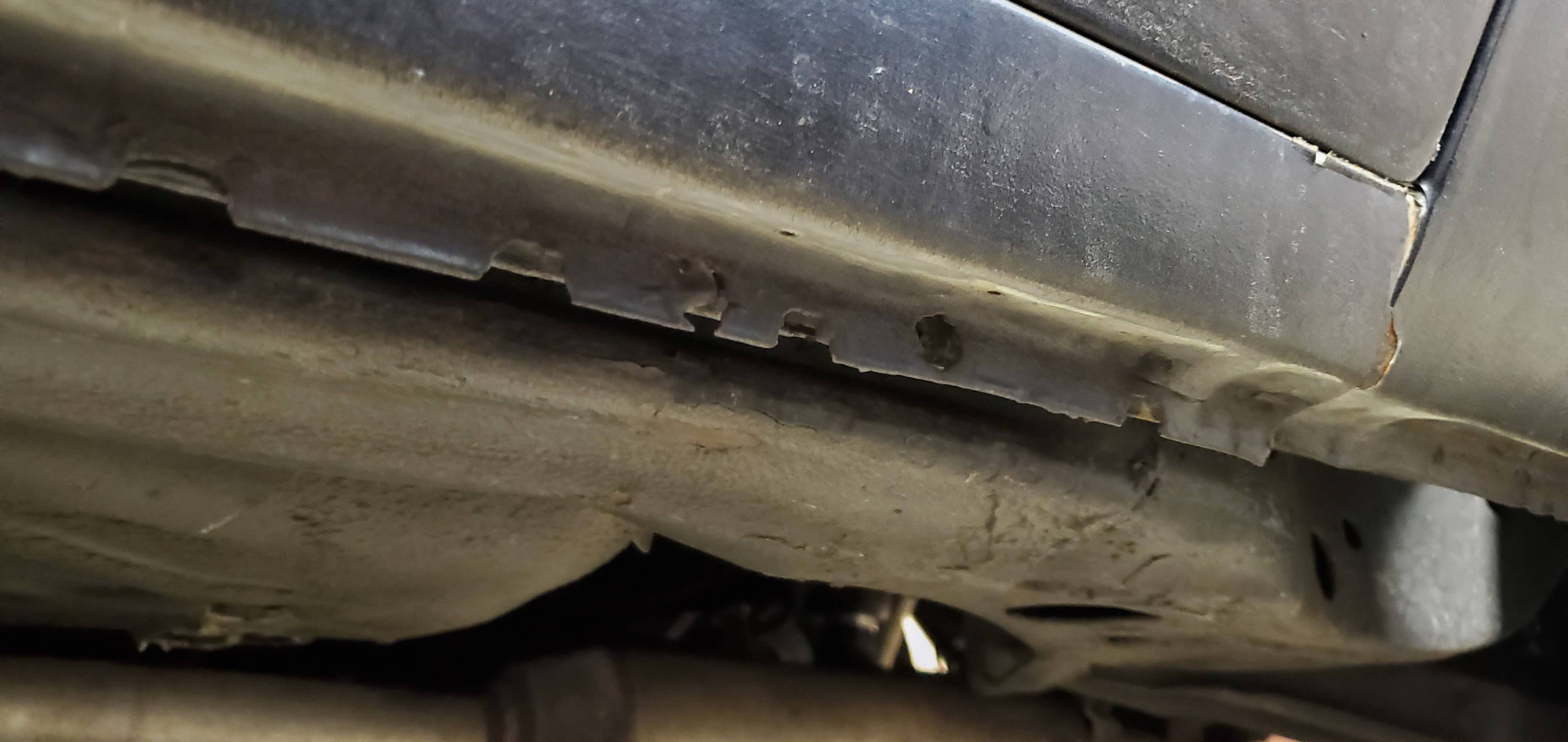

View attachment 198935View attachment 198936
Oh and forgot while I was looking at the fuel system stuff under the car I noticed the pinch welds didnt hold up on the driver side so used a couple zip ties to pull it back in for the time being
