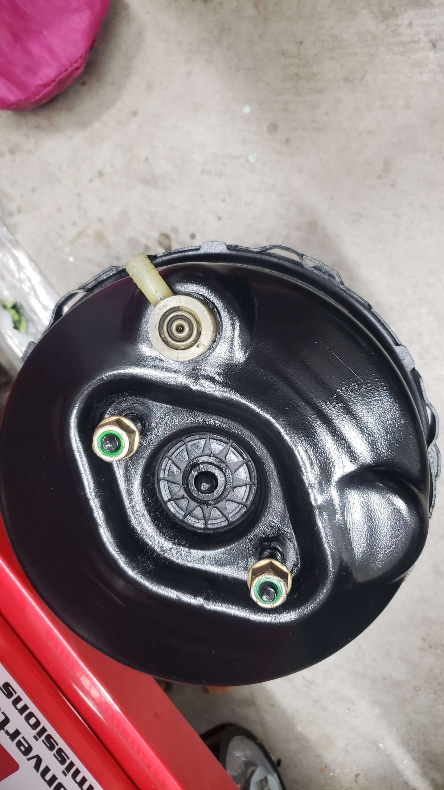

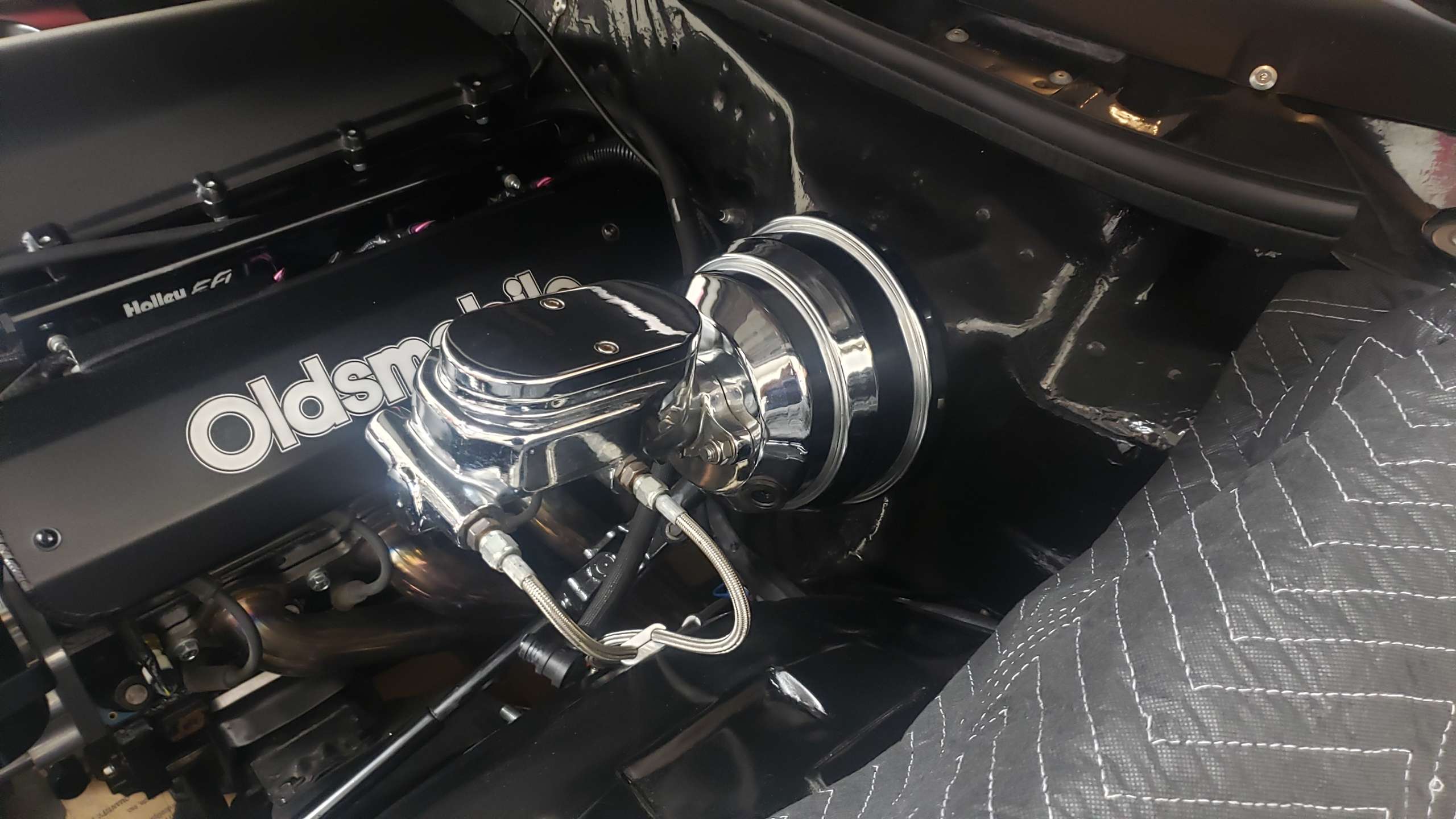

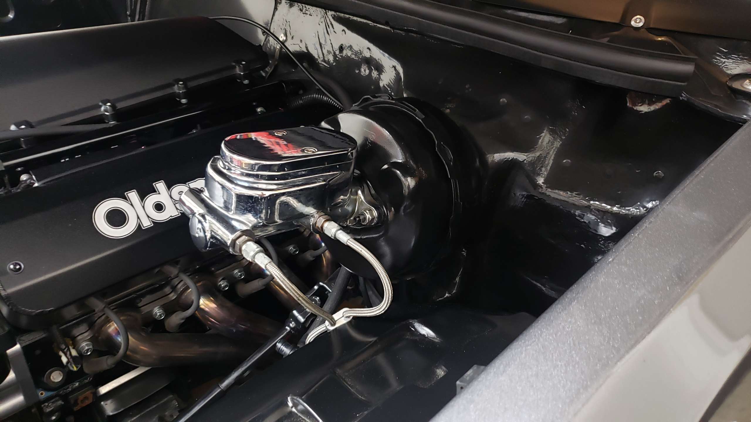

i know you had that oversized air brush compressor in he trunk for brake assist before,if you didn't have that hooked up and running it might explain the hard pedal.
That was a thought, but with the chrome booster the pedal is more normal. Just seems like the brakes are dragging. The only reason for the trunk compressor was the old engine didn't generate enough vacuum. The LS has more than enough vacuum for the brakes.

Catching up on this post as work has kept me busy driving. I've had an odd vibration issue since finishing my car and it's driven me crazy. Only does it above 60mph, but I've always noticed my brakes feel like they're dragging especially at highway speeds when letting off the go pedal. It feels like it wants to dive.
Been doing some thinking and wondering of the aftermarket master/booster are right. After checking specs, the master should be sufficient for my brake setup, but the booster is smaller than stock and the pedal rod seems to be adjusted wrong(my fault).
Soooo this week I got the stocker back out, threw some fresh paint on it and swapped it last night. Been a drought here for 3 weeks, then the day I need to test drive its raining. I'll hold off on claiming its fixed until driving, but just in the garage the brake pedal feels different in a good way. To be continued...View attachment 202217View attachment 202218View attachment 202219View attachment 202220
Well, that test drive sucked! It was hard to even press the brake pedal going 20mph or less around my neighborhood. It legit took both feet to stop. Guess I'm putting the other one back on and re evaluating the issue.

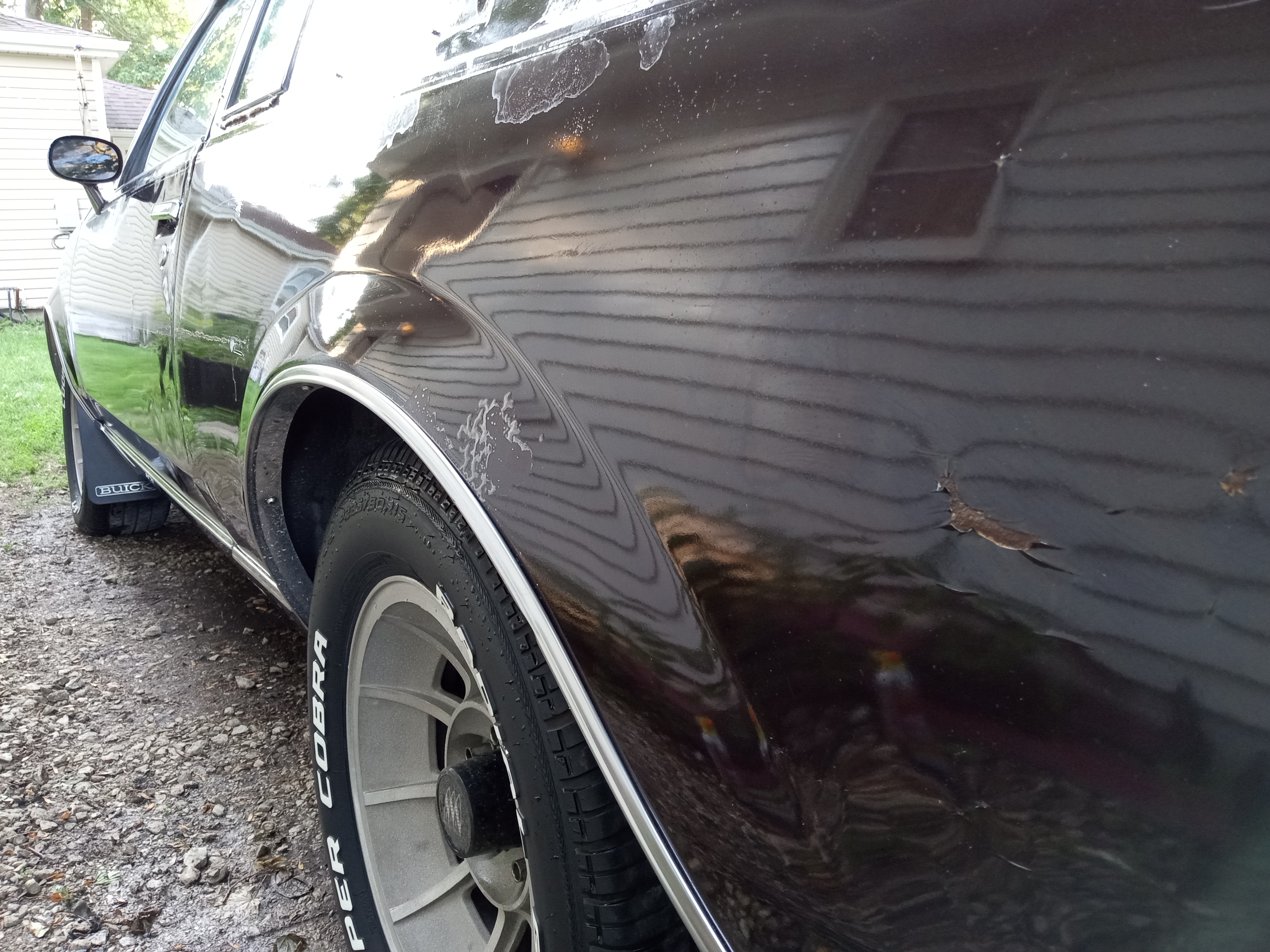

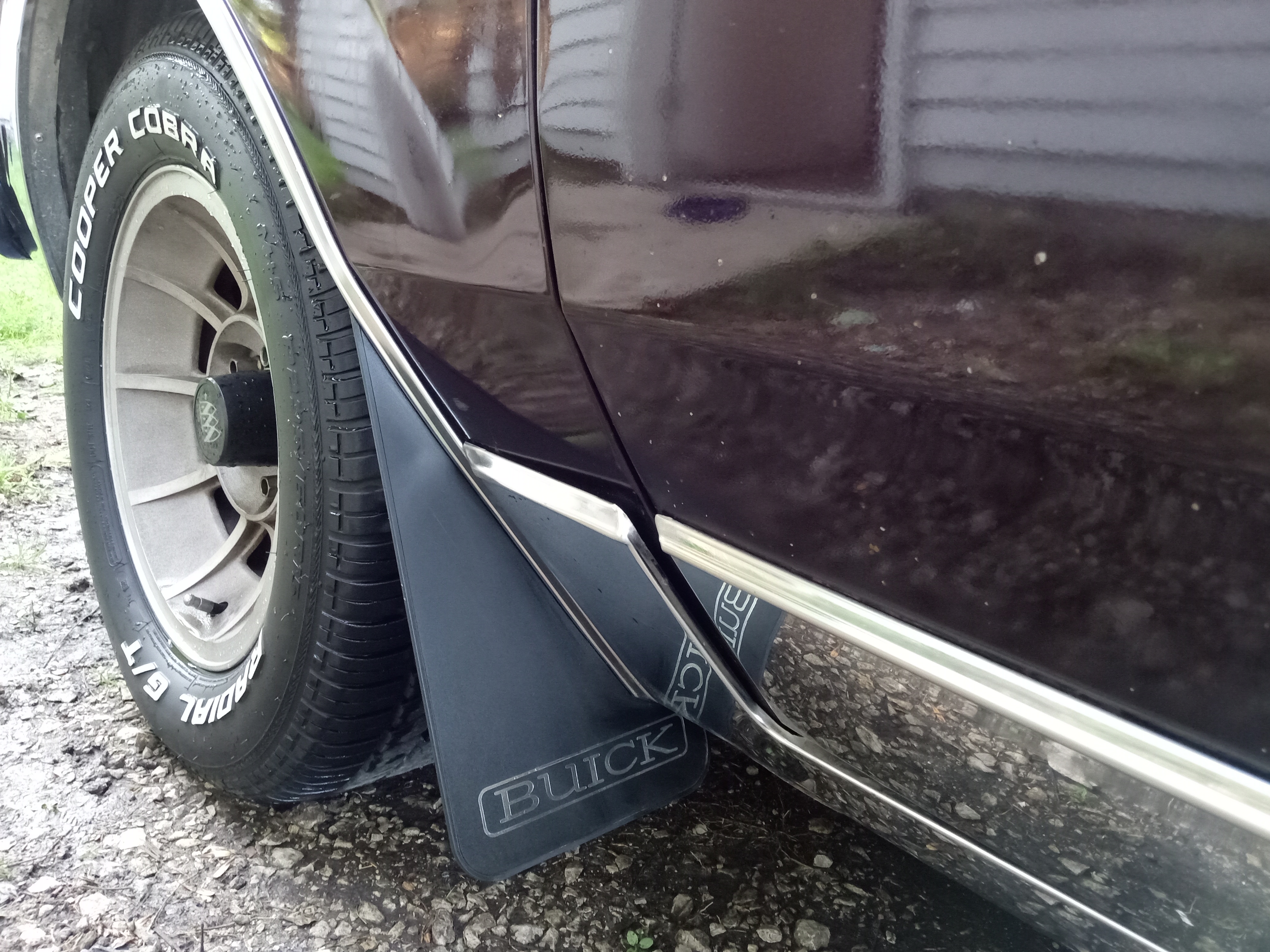

Replaced drivers bumper marker bulb.
few days ago put on some dinky ebay mudflaps.

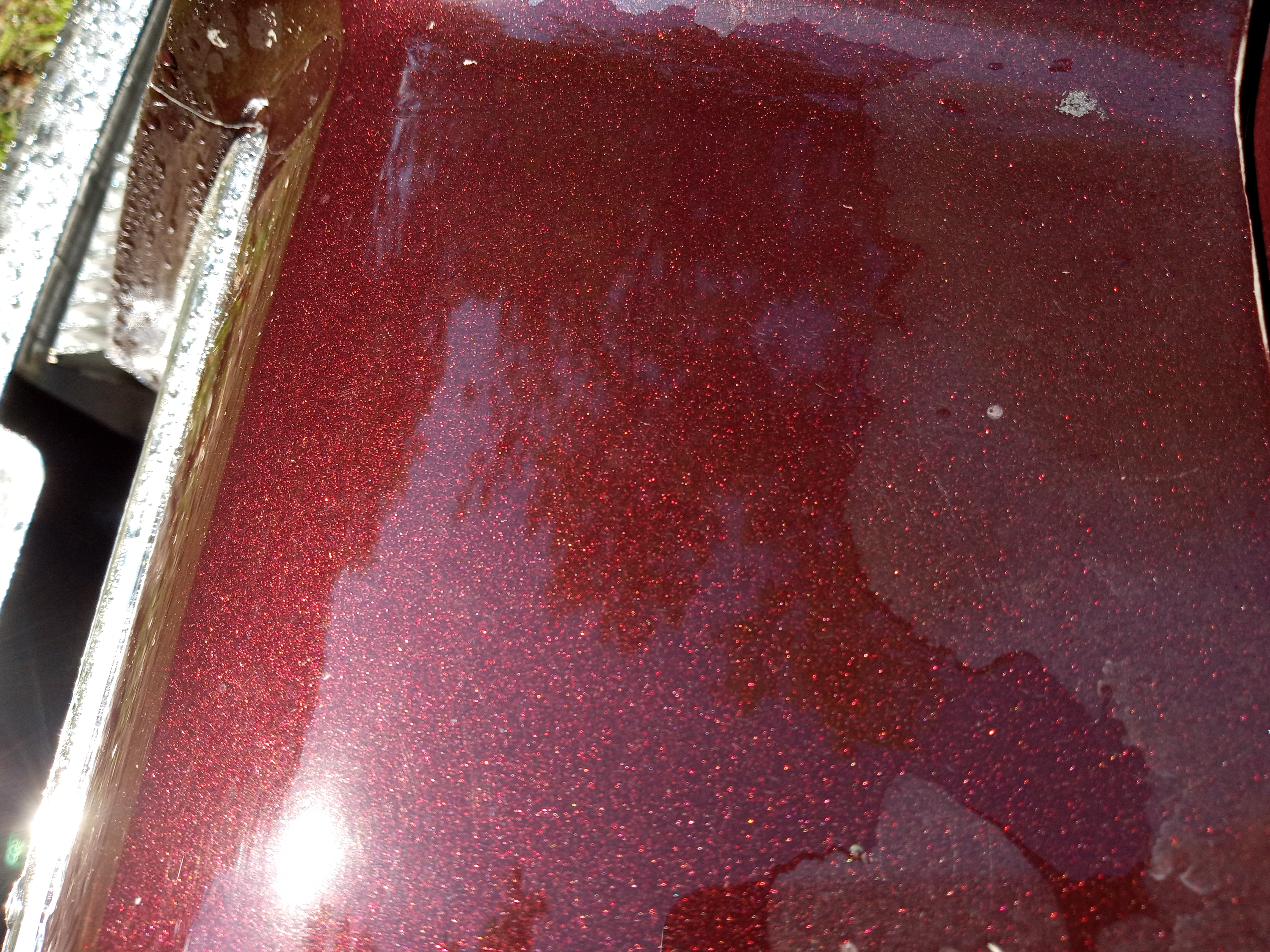

Washed it yesterday. Rubbed it down with PB blaster and one of them soft dense microfiber rags.
View attachment 202546View attachment 202547View attachment 202548View attachment 202549View attachment 202550
Gotta love our "old" rigs...lol
Try that wit a newer one(think plastic headlamp buckets, and "jeep" fender flares), and you'll see the root cause of frosted headlamps and whitish grey fender flares that look much nicer in original black.
