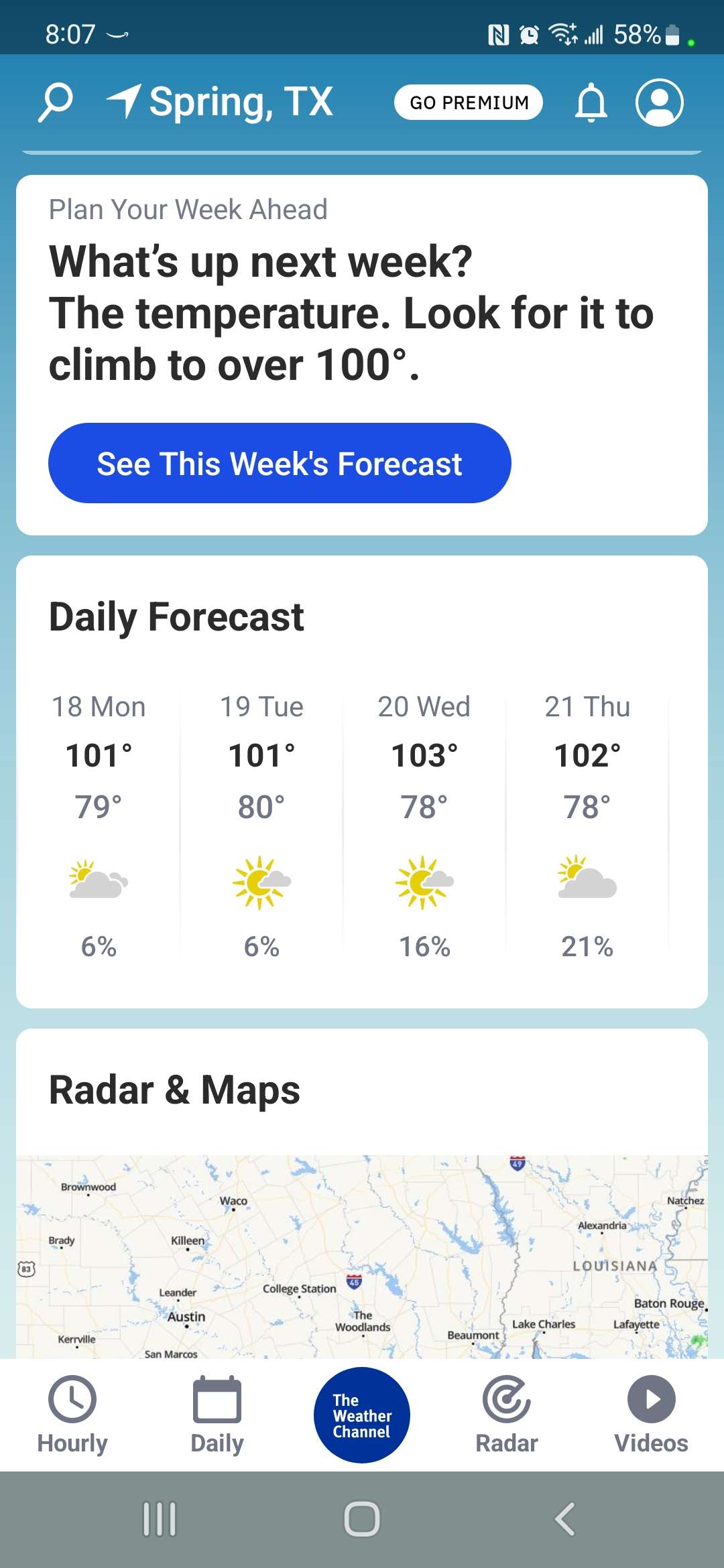

it's gonna be a sticky week,in the commonwealth stay hydrated
