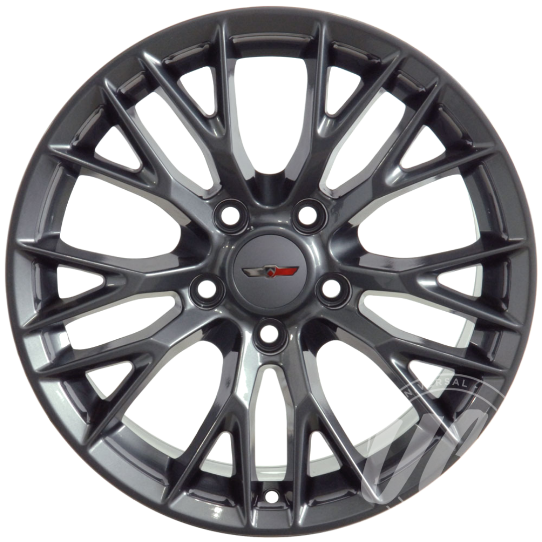

Thanks, I am spending much more time than I would like to admit looking for wheels since I have only found one set that I think would look decent but want to take advantage of the lip I can put in the back. I do like the look of these
But think these would look much better in 18/20, problem is the smallest they make is 20 and I don't want to spend the 4 grand
But very glad to see that someone used my idea of all teal so that I know that it will look OK
Thanks, I am spending much more time than I would like to admit looking for wheels since I have only found one set that I think would look decent but want to take advantage of the lip I can put in the back. I do like the look of theseView attachment 154770
But think these would look much better in 18/20, problem is the smallest they make is 20 and I don't want to spend the 4 grandView attachment 154771
