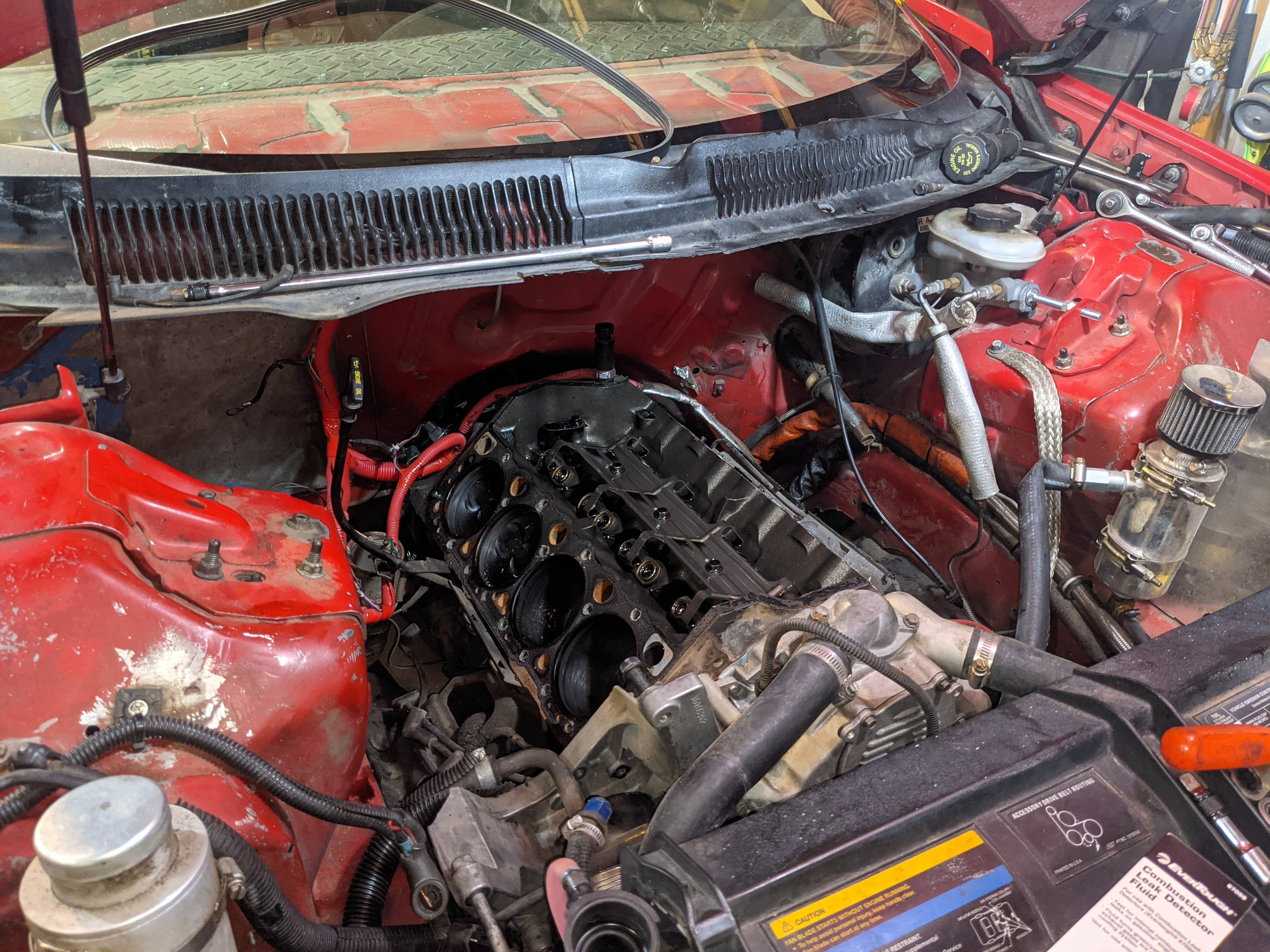

Last night I dropped $800 in entry fees for the OK race and a cheater practice session for next weekend. After my issues last weekend I chickened out and found myself here tonight.
I checked the passenger head with a straight edge. I couldn't get a .003" feeler under it. Seems that perhaps the one radiator cap gets hot and let's go as I initially suspected? 1 session was not enough to instill confidence with the other cap, but 2 good head gaskets will do. These heads aren't going back on. Though within spec I want them legit decked and the seals on both are all over the place. Here I'd been blaming my first time garage hone job, but the seals indicate otherwise. It'll be nice to fire it up and not watch a bigass blue cloud want on by. Or maybe I'll miss it? It sure was entertaining to fire up the Red Dragon and fill someone else's cabin with half burnt Valvoline SAE40 VR1 'Murica dino oil. I intend to be back up and running tomorrow.

You underestimate the amount of smoke it was rolling. It would have concerned a lesser man than I.
Sounds like my old firebird. Has about enough smoke to simulate a yard brushfire.
I'd really like to know what went bad inside, but, not enough to do anything with it yet. Car is sitting on blocks and stands about 3 feet in the air for the past couple years, and on gravel in the yard before that since... mid 2000s anyways.
