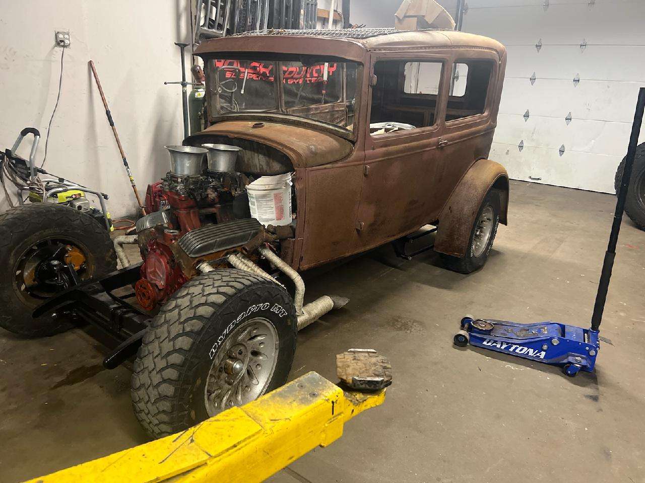

Clutch, thinking that by wood, you mean the subframe rails that run along the bottom of the cabin sides, made of oak or maple?? Have to look but think the Snyder's Vintage A parts catalogue has them listed; have the book somewhere.
Factory original component that had moisture incursion that started the corrosion cycle which killed it. Probably had been dying for quite a while.
He actually has them all the original wood is there and in great shape. In fact I've never seen an original body with so little rot or all it's wood left. The pieces I'm referring to were like small shims at the mounting points when it came apart maybe they weren't factory. Best I could describe them as is wooden rectangle body bushings. We just left them out to drop the body a little bit.
