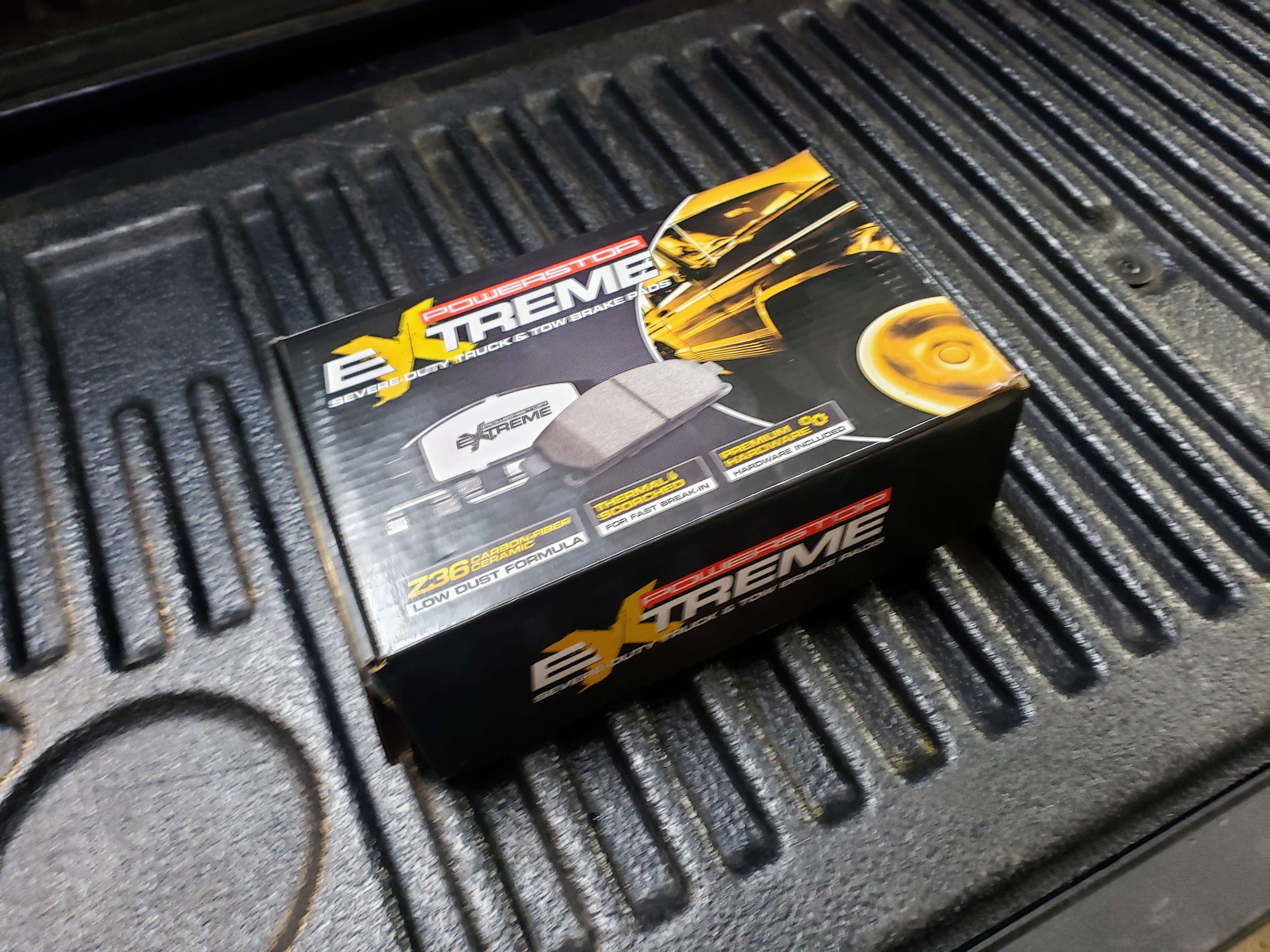

My F150 is due for inspection and I knew the rear brakes were gonna be close so I bought a set of pads and swapped them out today. The original pads have lasted 87k miles so OEM was my first choice but they cost about $75 after shipping from Rockauto which is a bit more than I wanted to pay. I've read a lot of good reviews on Powerstop Z36 brakes and they were about $30 cheaper, so that is what I went with. The old rear pads still had about another millimeter or two left on them, the rotors look perfect. There was one stuck slide pin with a torn boot but it hadn't affected the pad wear yet. I got it freed up for now and a new boot on the way.

Let me know how they wear in and how happy you are with them vs the Motorcraft stuff. 90k isn't bad for a truck that's both heavy and doing truck stuff.
We did the pads on my wife's beater '16 mustang. Had 135k on the original pads, rotors still OK. Pads were probably down to about 30-40% wear remaining, but, with the mileage I had figured it was time and had already bought them before taking things apart to check so... it wasn't horrible though, price-wise. Only reason I stuck with Ford was I figured the engineers likely balanced the steel hardness of the rotors and the material of pads for wear. I know plenty of those 'lifetime warranty' brands purposely make one thing or the other harder and all of a sudden your 'lifetime pads' chew into the rotors fast... or vice versa.

Power stop is who I used for rear brake shoes on my dually. They're semi-metallic bonded shoes, the only ones I could find like that. They have a GG coefficient of friction and are super aggressive, too aggressive for an empty truck. I've been very impressed with them and it's left a good taste in my mouth for the brand.

Were they quiet the whole time?
Mine had 52k and the rears started squealing on reverse. I bought motocraft ones because default and the old ones weren't that worn, maybe 70%?, but the new ones solved the squeal noise.
