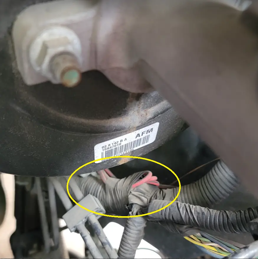

friend of mine pointed out a weirdness under the hood on my 08 Silverado today, something never noticed. on the wiring harness under the master cylinder, down by the firewall, there is a wire with a large flat ring terminal that is folded up external to the harness conduit cover and then electrical taped to the outside of the wiring harness. the wire color is red with a black stripe. anybody have an idea of what this might be?
I'll try to get a pic posted tomorrow. but here's an example of where it would be with the yellow x/circle

Most likely aux power for a trailer connection. Is there an unused power post on your fuse block? Other end may be taped up at the back of the frame. My trucks had an orange and blue wire taped up in the same area, one for power and one for trailer brakes.
aux power for a trailer? we thought it was factory due to the way it looked, ok so maybe. I do have a factory trailer towing package and hitch, with the round plug, but I've never towed any trailer with brakes. I'll have to take a look underneath at the rear now and see what is what
DRIVEN replied it was for trailer brakes. I wasn't sure if you saw that.
I saw that but had no idea who he was posting for. makes sense now.
