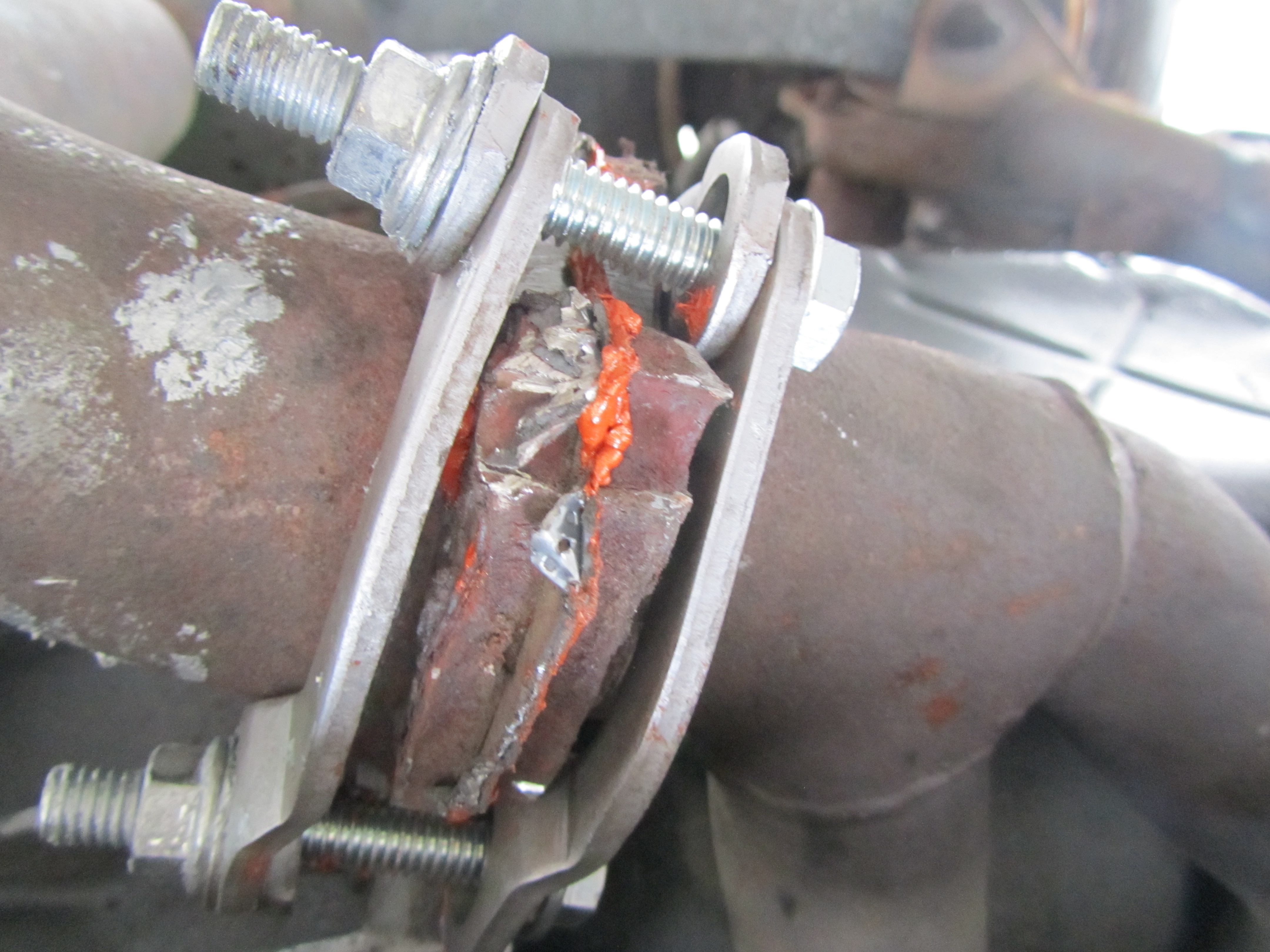

The GYP had an exhaust leak at the flange where the head pipe meets the crossover pipe. Normally I can just cut the rotten studs off and bolt it but the flanges were too rotted. Replacing the pipes was not an option because there are two CATs on the head pipe that are working fine. So I found some universal flanges at Advance but the bolt pattern was different. I had to grind down slots in the flanges for the bolts to pass. Much cussing later it all fit together. I used a stock GYP flange gasket schmeared with the high temp copper RTV so it should not leak. As you can see the clamping area is just gone. Good ol' NOPAR metal. It may be ugly but it is quiet and that is all I care about. IMG_0660.JPG
The GYP had an exhaust leak at the flange where the head pipe meets the crossover pipe. Normally I can just cut the rotten studs off and bolt it but the flanges were too rotted. Replacing the pipes was not an option because there are two CATs on the head pipe that are working fine. So I found some universal flanges at Advance but the bolt pattern was different. I had to grind down slots in the flanges for the bolts to pass. Much cussing later it all fit together. I used a stock GYP flange gasket schmeared with the high temp copper RTV so it should not leak. As you can see the clamping area is just gone. Good ol' NOPAR metal. It may be ugly but it is quiet and that is all I care about. View attachment 219848
Instead of that RTV (if it fails), you might just smear muffler cement on either side of that gasket. I recently had to replace a warped flange with 2 pipes that passed through it, I just lopped off and zapped some v bands in there. Your fix is definitely easier though.

I used to use that exclusively. But after I started a thread about exhaust sealers I changed to the Permatex high heat copper stuff. The muffler cement works well but eventually gets wet and crumbles off. The last time I did some new pipes I used the copper stuff and it looks as good as the day I did it. We shall see. This PITA flange is known for leaking even under the best conditions. Replacing the two pipes,two CATs, and a resonator is not cost effective.

Plus 100 on the Permatex High Heat Copper RTV. Like the ad says, "i use that s*** on everything!"......................well, almost everything, it doesn't go well with ribs.🤣
