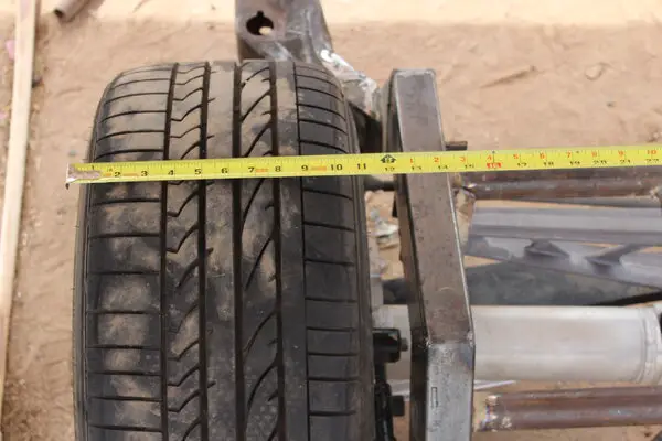

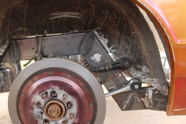

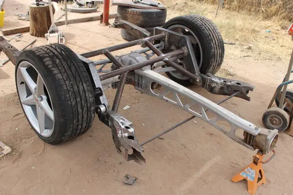

11 half inch on monte carlo
it fits
  • narrow frame 4 inchs
    Votes: 0 0.0%
  • fender well shorten 2 half inchs per side
    Votes: 0 0.0%
  • Total voters
    0
antonC4Gbody
Apr 26, 2018
15
arizona
19x10 inch rim and 14 inch rotor
antonC4Gbody
Thread starter
Apr 26, 2018
15
arizona
enjoy more pictures after the frame is welded on

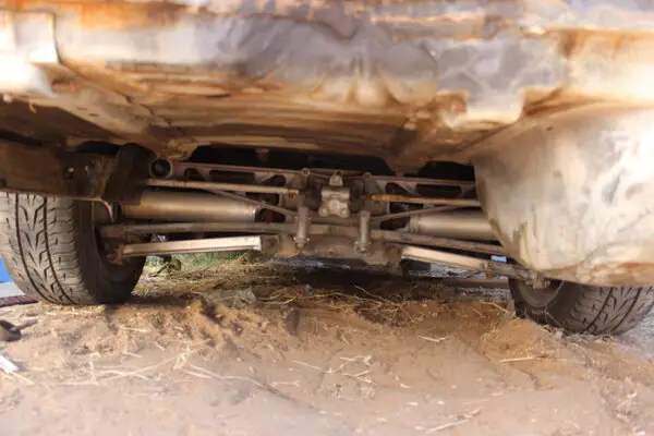

How are you keeping the frame sections aligned so all the body mounts stay true? I wanted to do this swap with a GTO/G8 subframe swap...
:popcorn:
antonC4Gbody
Thread starter
Apr 26, 2018
15
arizona
:popcorn:
the new frame fit inside the original frame and had brace welded on outside before cutting anything. I have video on youtube under [11 inch tire on narrow frame G body]

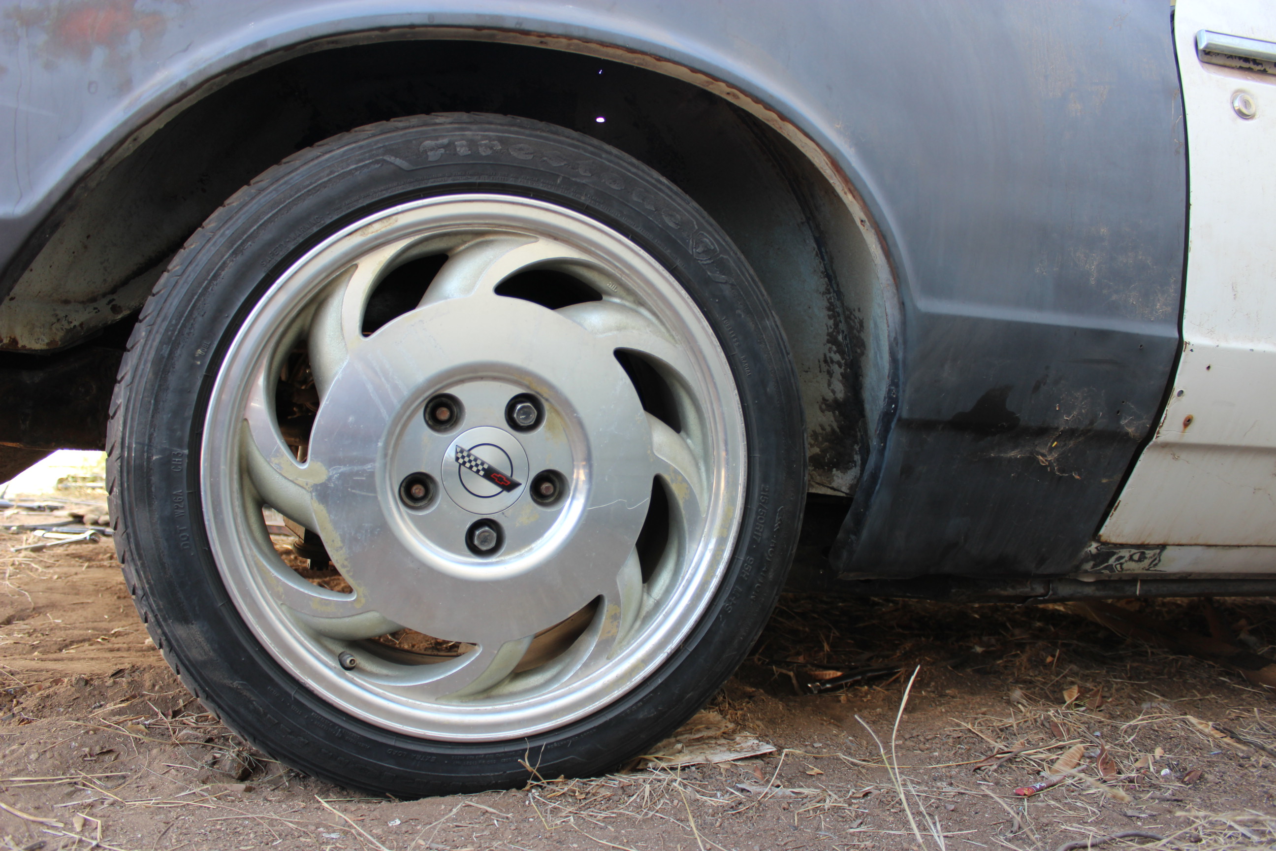

liquidh8
Lower or a larger tire? Should handle be pretty good with all that rubber on the ground.
