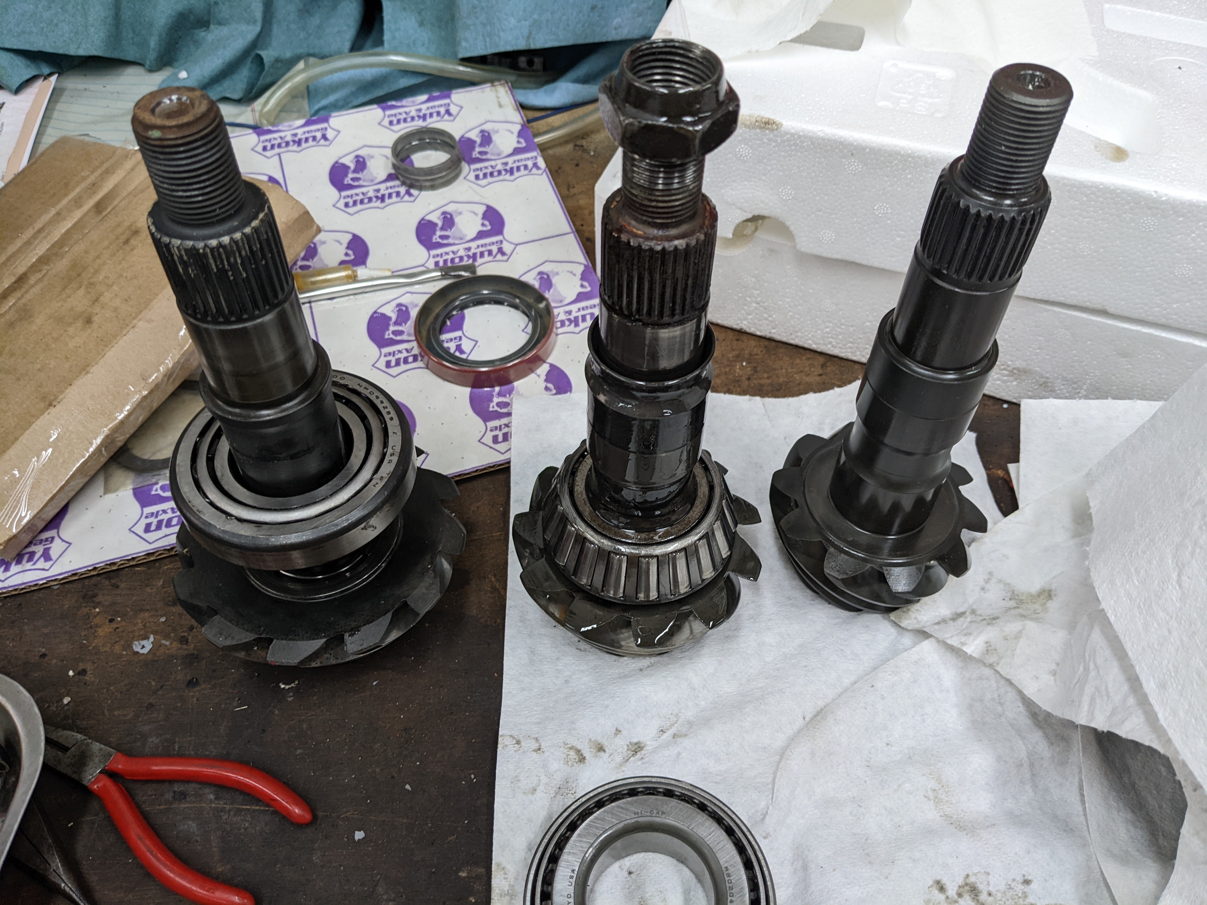

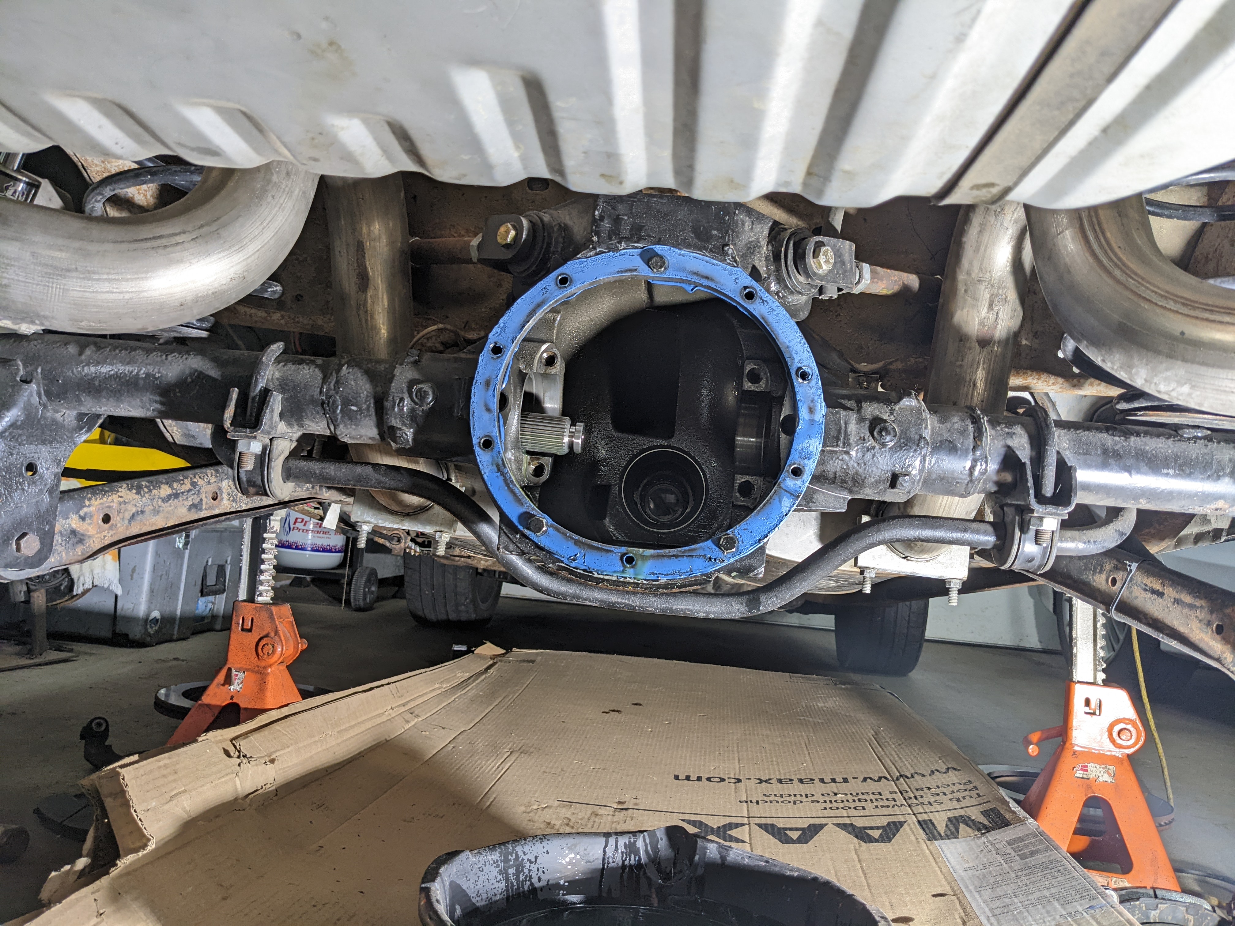

Swapping gears in-car. You're a wild man. I did it (unsuccessfully) in my truck in the driveway about 10 years ago. I don't think I'll try that again unless if I have a lift.Blasted the rear end apart tonight to swap to the 4.30's. Stole the rear pinion bearing out of a spare set of 3.42's with the intent to grind the ID out and found out the 99+ 8.6 bearing cone angle is different than the 98- cone angle so I can't salvage that used bearing for setup.

Look at my bare rear end
Hopefully I can scrounge up a set up bearing quick cheap locally and install. I need to rig up a pinion depth gauge also.
