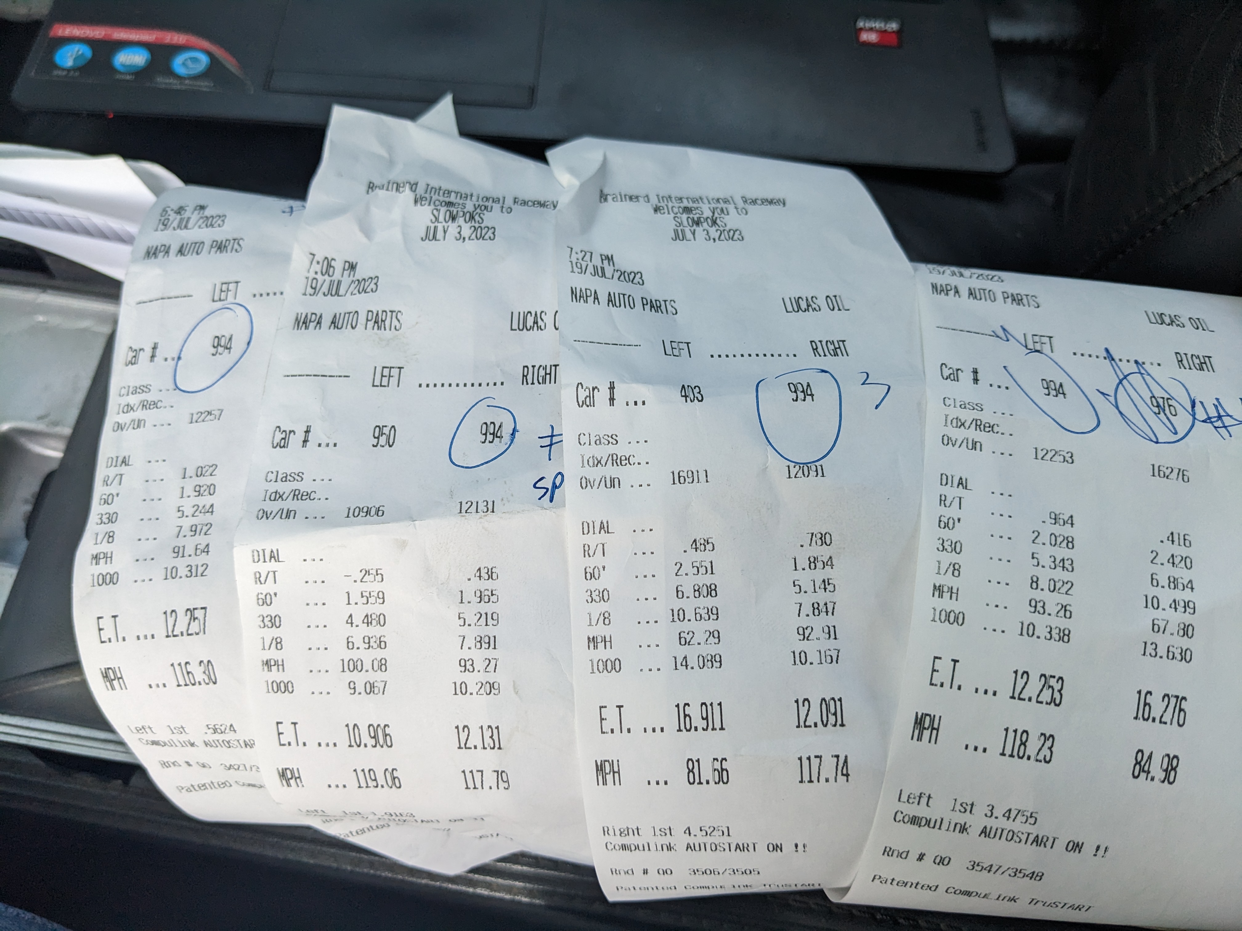

Had the urge to get to the track and try out my suspension tweaks I made this winter.
With having the baby in April, I haven't had the chance to make it to the track. Had an opening last night and took it. I was shooting for a 10.99 considering I ran a 11.10 last fall wadding the tire up and some opportunities to improve.
150 miles north-
Results? A bit lackluster. There was little to no track glue down because it was a 'street' night and I couldn't get a bite out of the hole. I was launching at 4800rpm last fall, I dropped down to 3600rpm and it still blitzed the tire hard. Didn't matter how much I took out of the hit or slowed the clutch apply down, as soon as the clutch grabbed and the 2 step turned off it blitzed the tire. I pedaled every time.
At least it was consistent. Didn't miss a single shift. Still .3 seconds slow in the 60ft. Usually it 1.58-1.65 so 1.85-2.0 was a bummer. They say a tenth in the 60ft is 2 tenth in the 1/4. If I could chop off .6s I'd be at 11.50 again.
I was also down 7 mph. My timing was neutered because I got a watered down tank of e85 (I was at 47%), the DA was about double what I am used to running in, and my IAT was unexpectedly high.
I still had fun, did a 300 mile round trip and no major mechanical failures.

Finally got around to processing and analyzing my gopro footage from BIR a few weeks ago
Basically between last fall where I ran the 11.10 and last outting where i ran a 12.09
-I had 20% less ethanol, e65 to e45
-I had 4 degrees less timing because of the bad ethanol content
-I had 30 degree warmer IAT post blower, 175 peak to 205 peak
-I was sticking 4800 rpm on the launch last fall, I had 3400 in last outting and still ripped the tire off not much outta the hole
