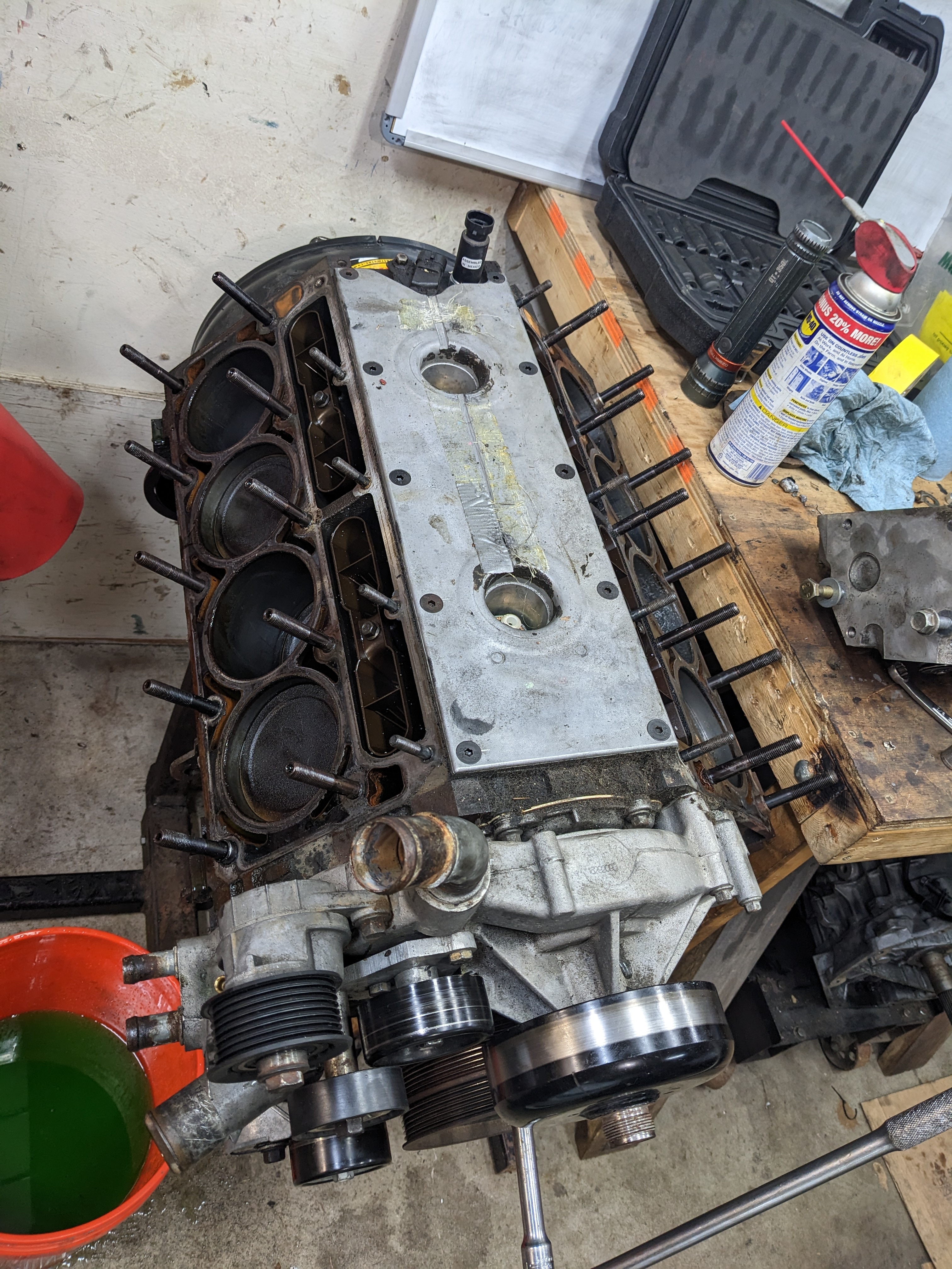

Head gasket looks good. No signs of lifting, it was still stuck down nice.
LSA MLS with chyna studs from 2014.

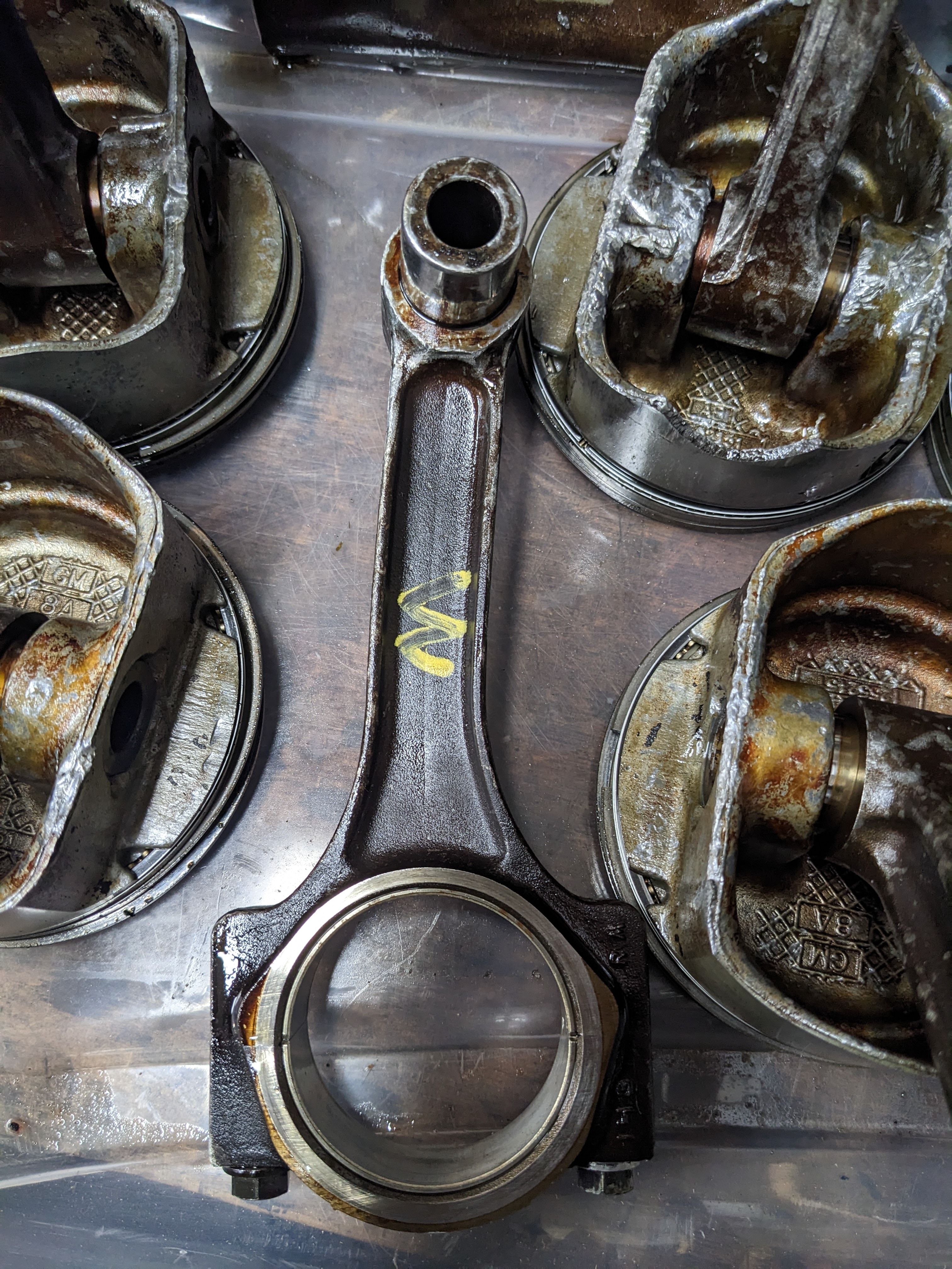

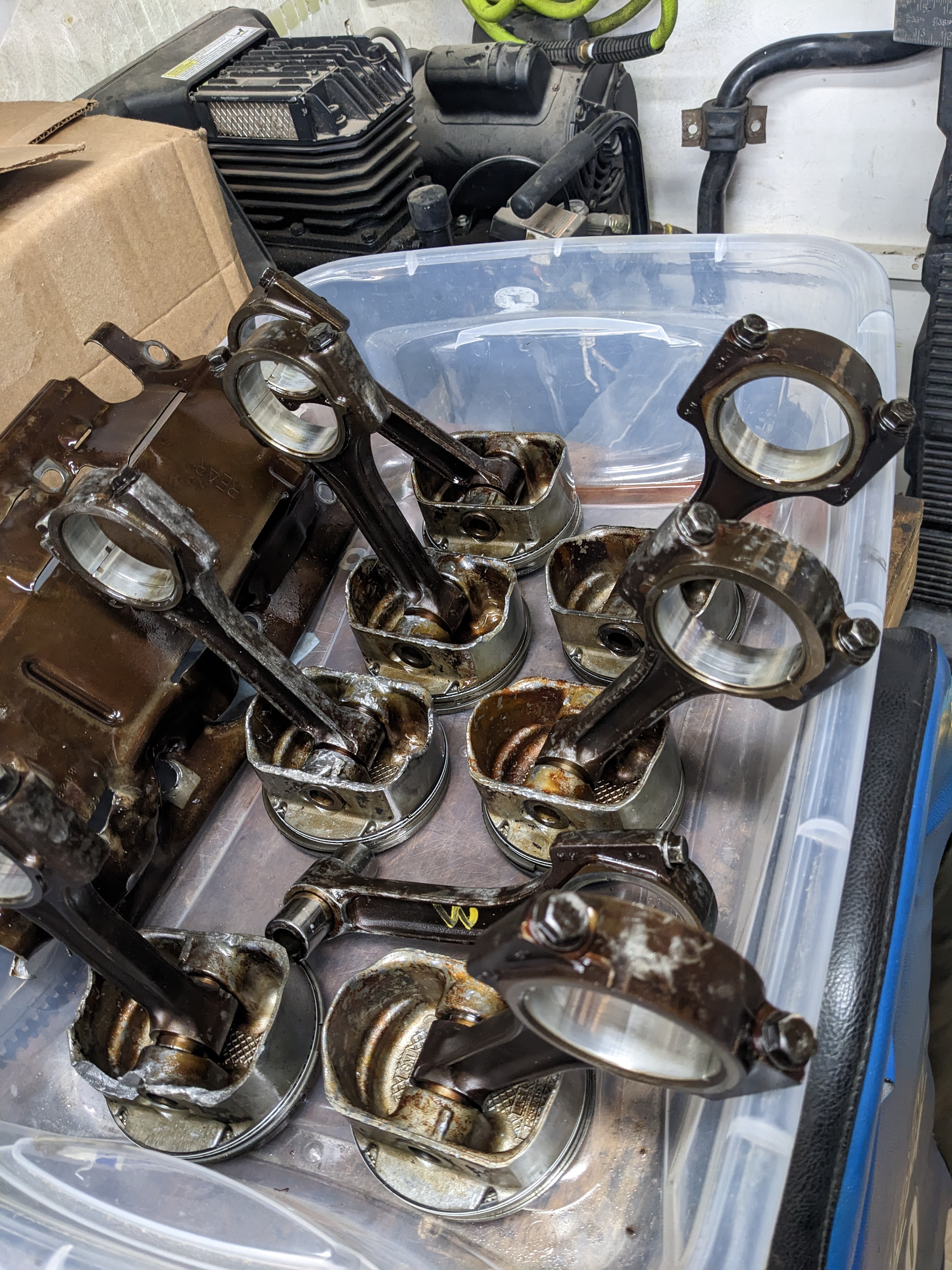

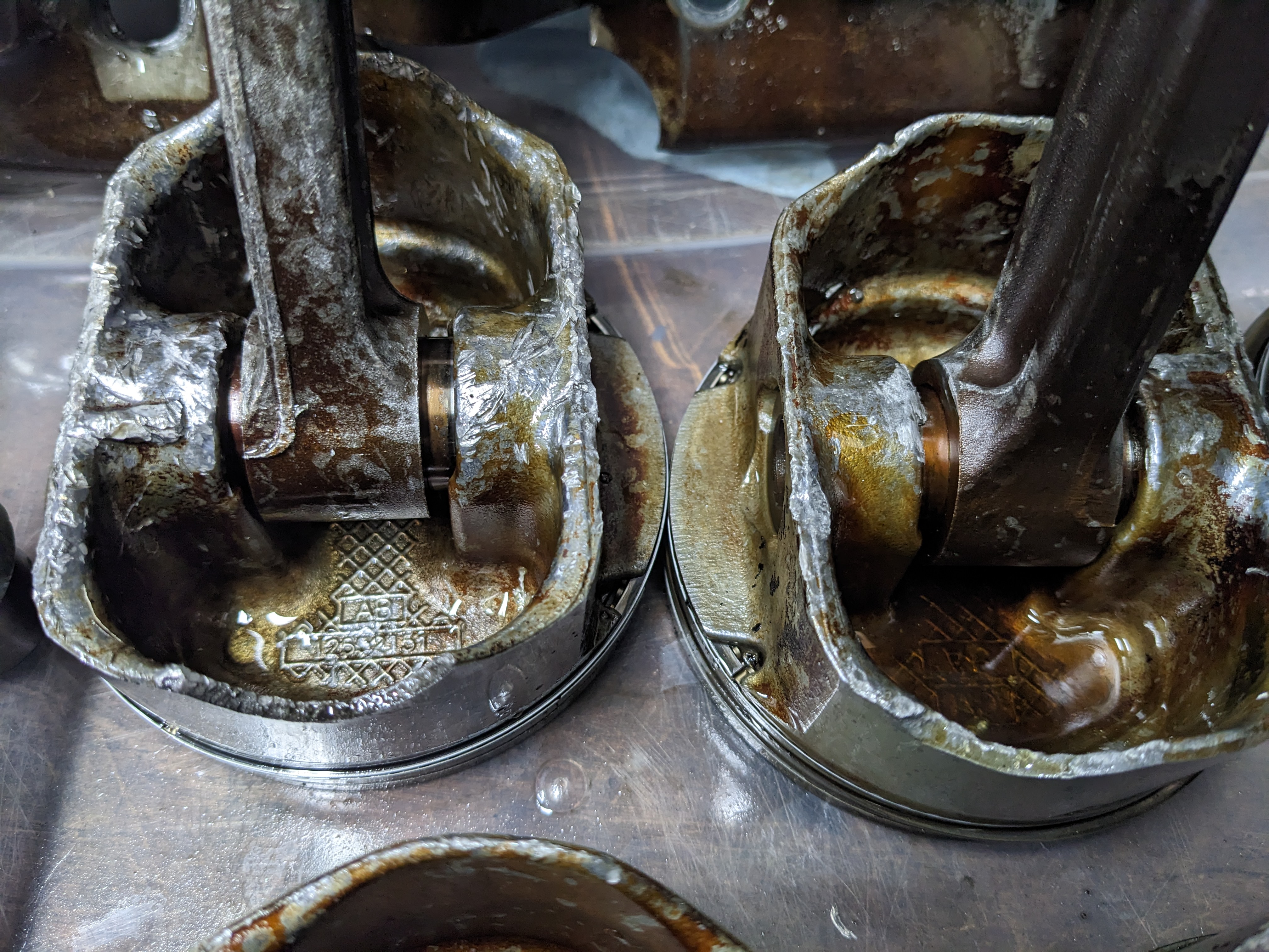

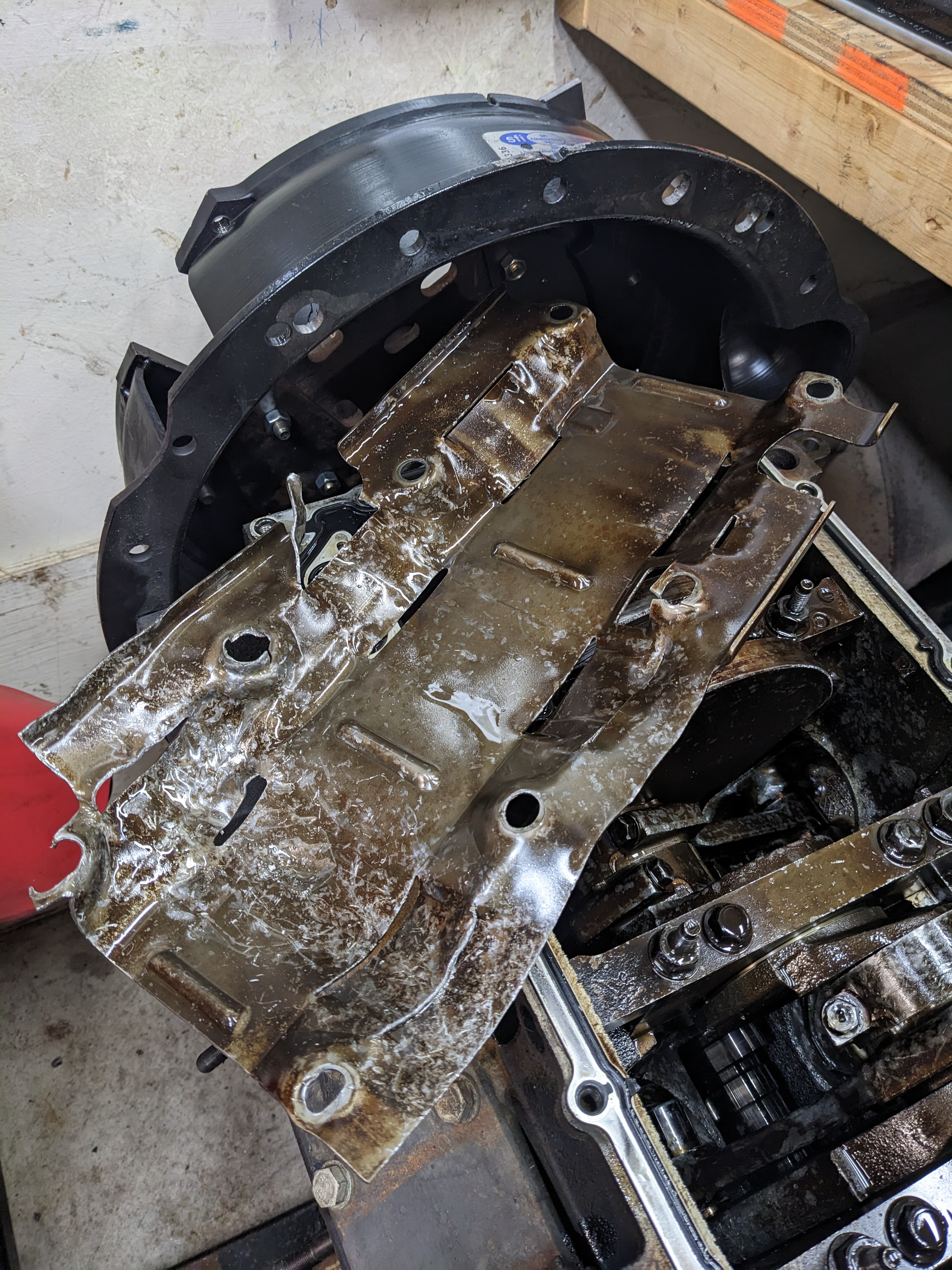

Pulled the passenger head, pan, and pistons out last night
Autopsy says
-expensive holley pan-needs welding, pickup tube is bent, dented and scrap
-windage tray is scrap
-my BTR blower cam is scrap, thats a tough pill to swallow
-4 of the 7 remaining Pistons have really bad skirt damage
-block has a really deep gouge in the cylinder wall and probably caused some risk of cracking, I don't see a sleeve being worth it
-#3 and #5 rods are bent
-2 cups of piston kibble scraped out of the bottom of the pan
#5 piston was .040 in the hole but all the others besides 3 I guess were fine
Good news
The crank is salvageable
The top rings were loose, 2nd compression ring was sticky but loosened up easily
No crushed ring lands
Bearings looked good especially considering it pumped a ton of crap in the pan
So my tune was likely ok, I just over powered and fatigued the gen 3 rods.
I killed it good
Autopsy says
Good news
I killed it good
View attachment 230668View attachment 230669View attachment 230670View attachment 230671View attachment 230672View attachment 230673
