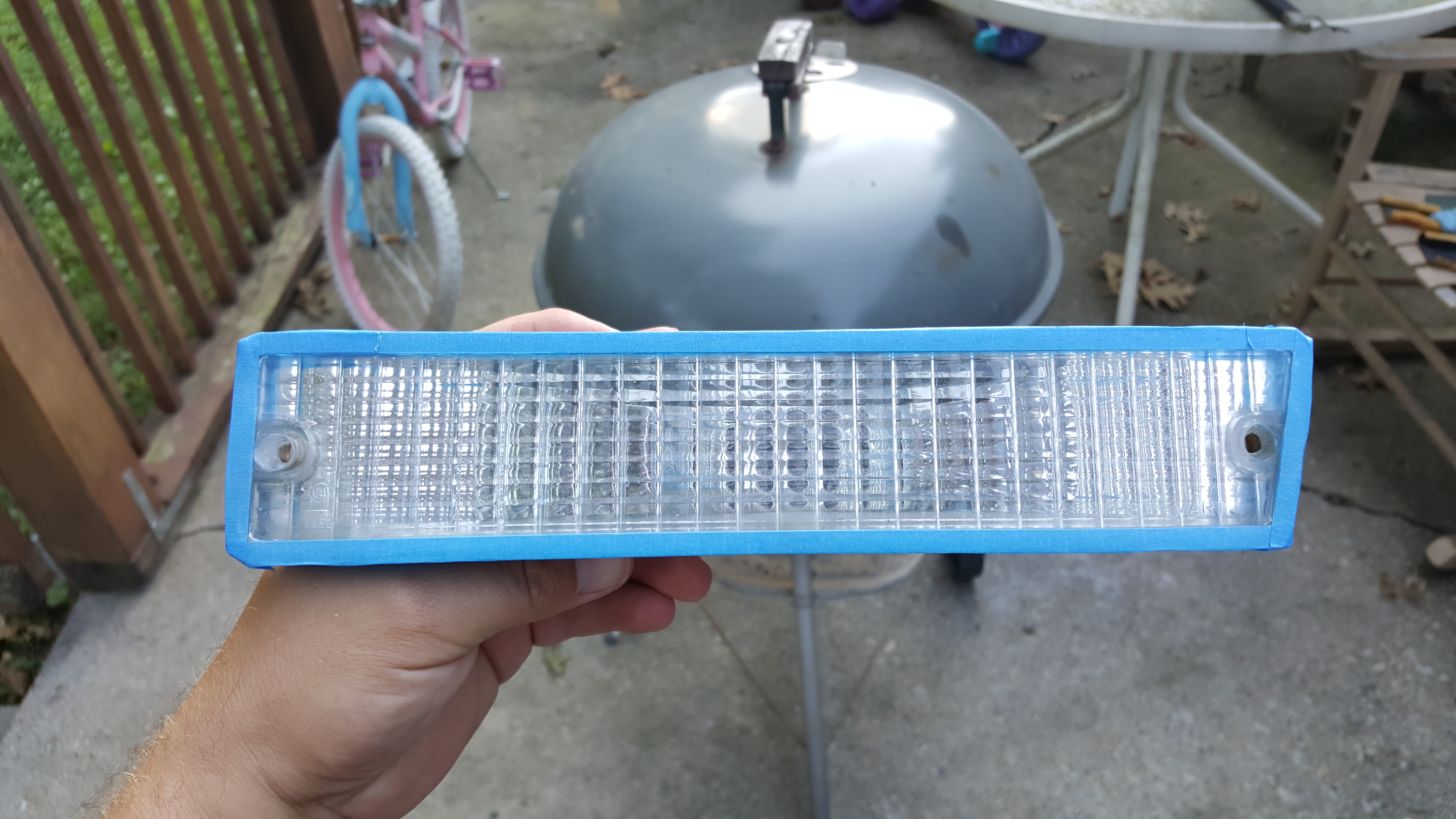

Yet again, I spent some time taping the turn signals off last night in prep for paint.

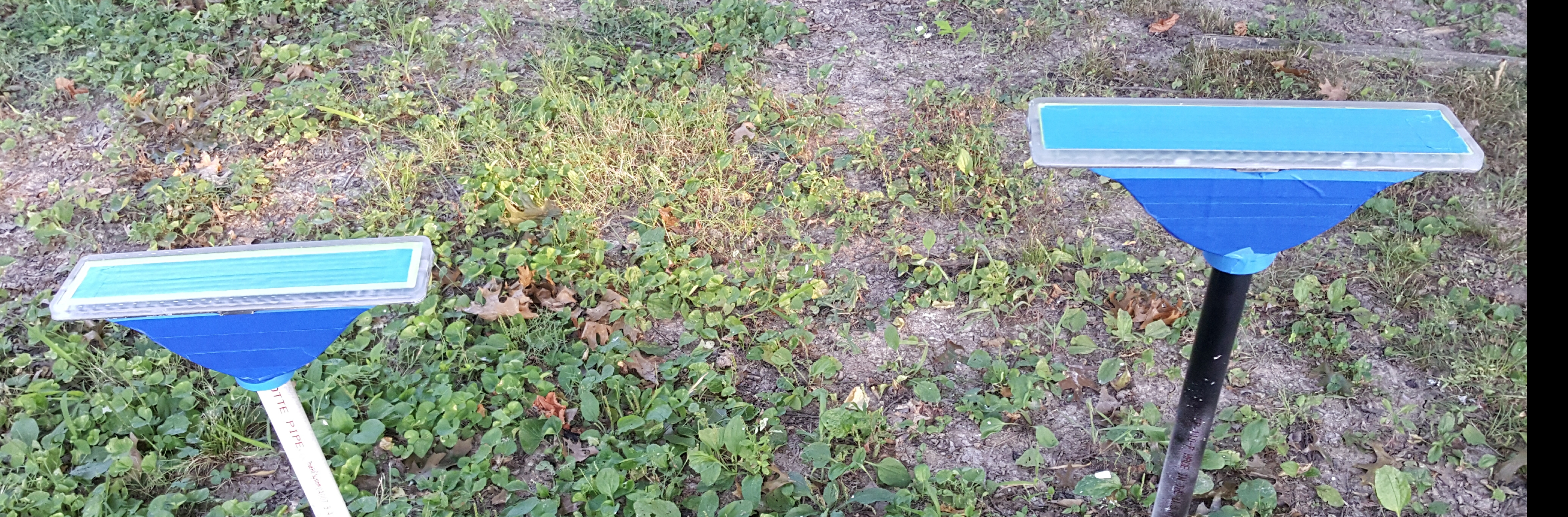

When I got home today it was a little more humid, but still in my "ok" range, so I got my redneck paint booth ready lol!

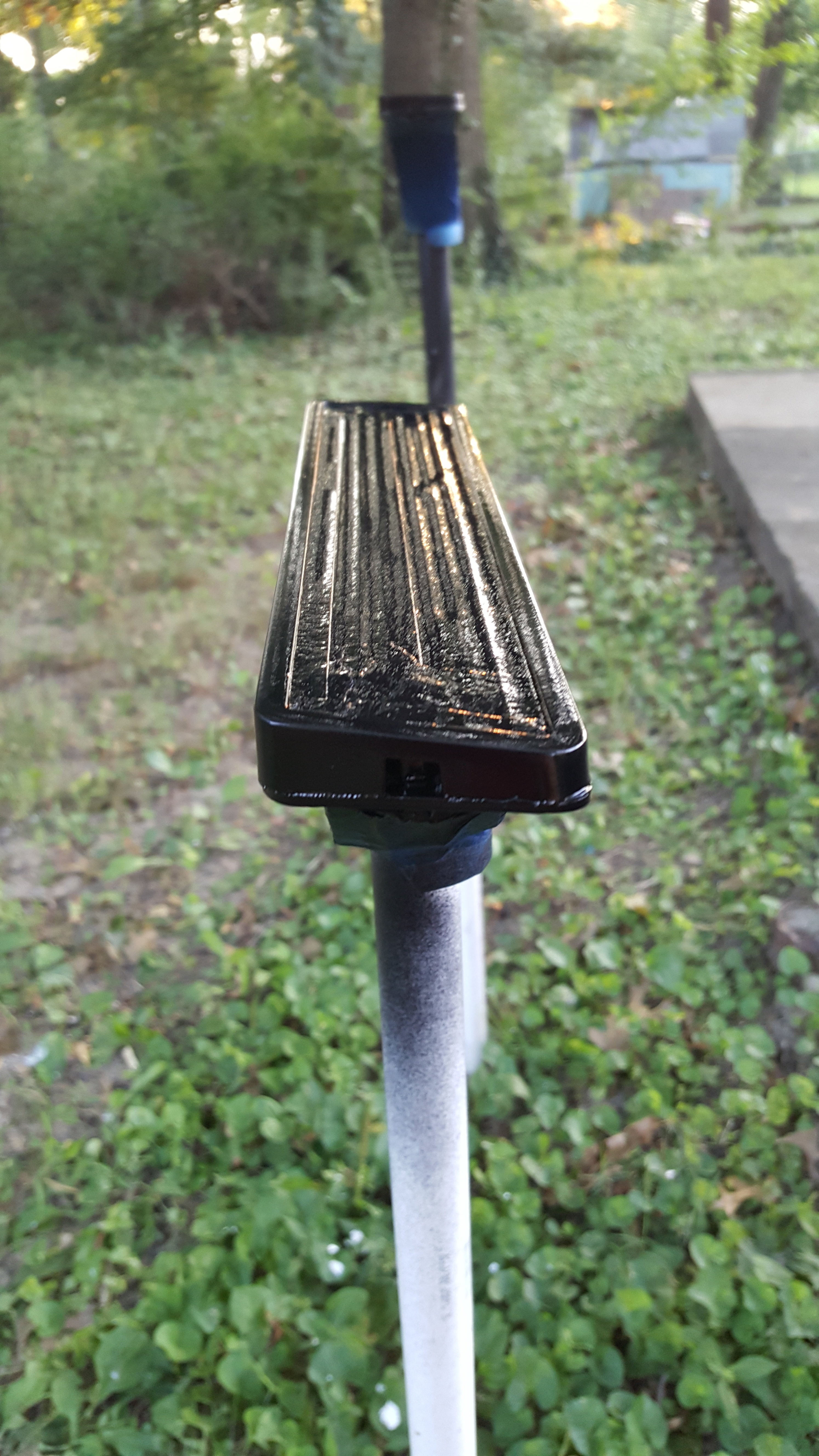

After a quick wipe down I got to it, a couple coats of adhesion promoter, primer, and then SEM trim black.

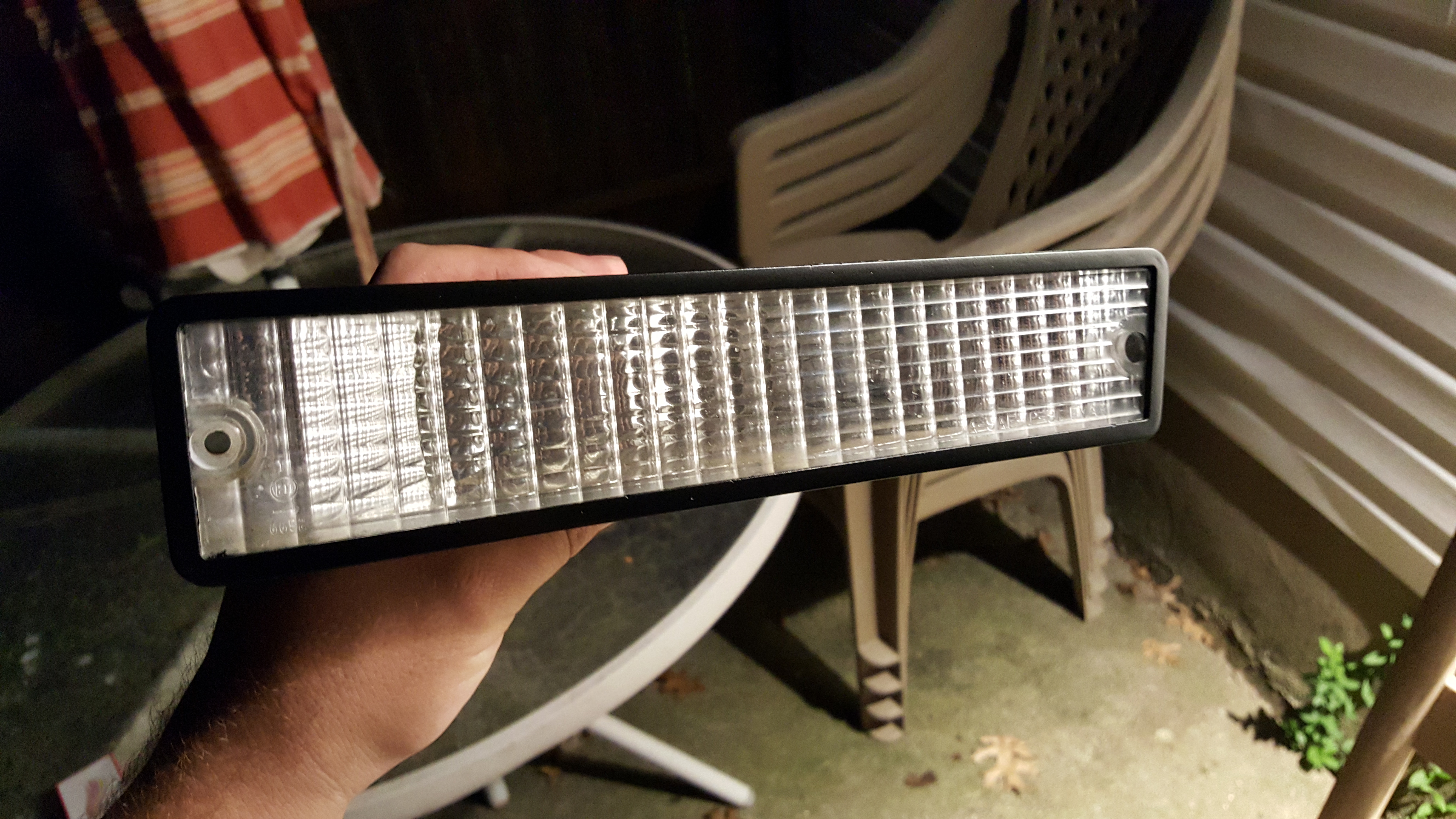

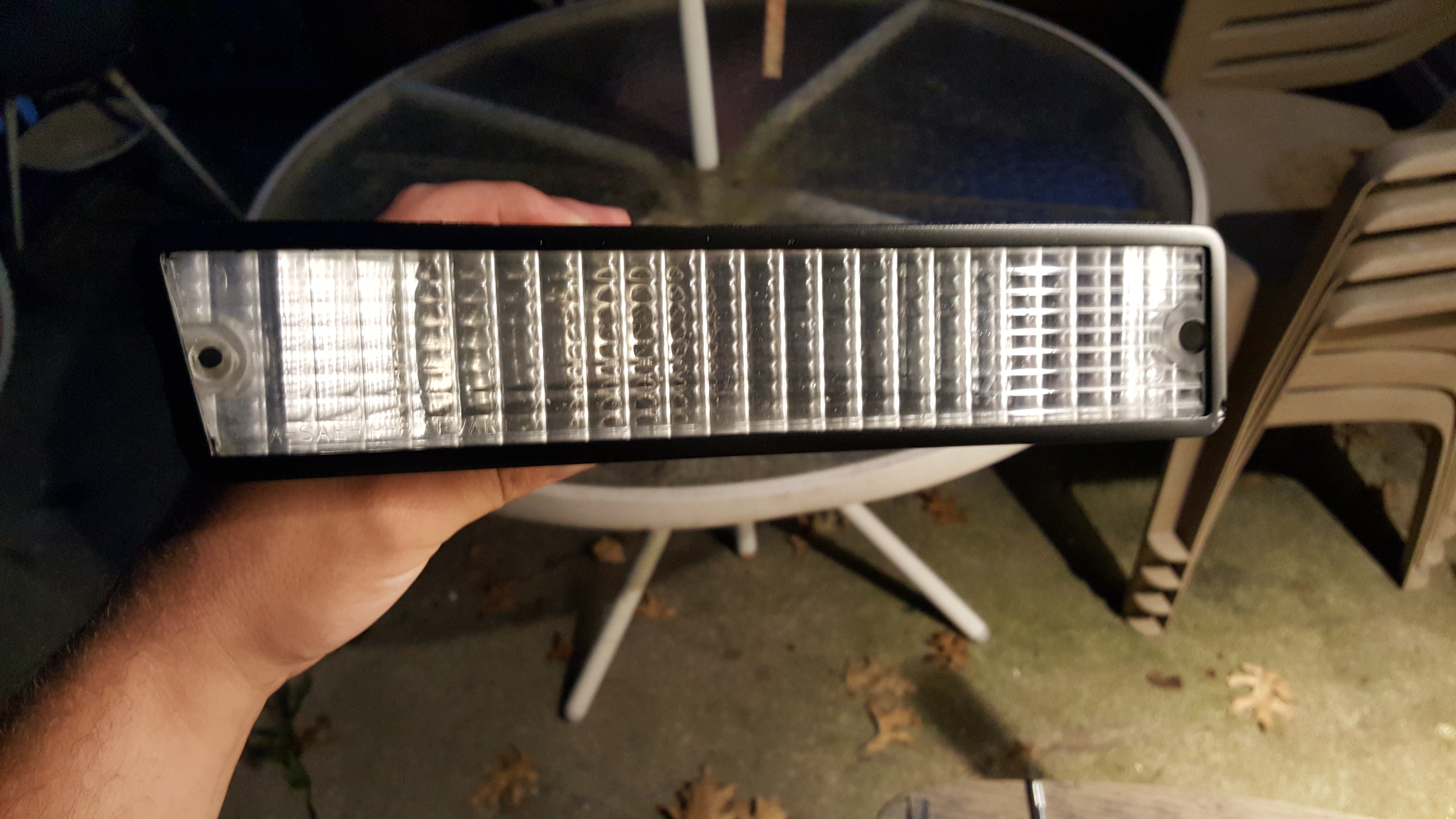

Once they cured for a bit, I untaped them and man these turned out great as well!
Once installed, the frame I painted black will almost disappear in the bumper, revealing only the lenses(or at least I hope). Thanks for tuning in guys, the feedback is appreciated as always!!!
When I got home today it was a little more humid, but still in my "ok" range, so I got my redneck paint booth ready lol!View attachment 70661
After a quick wipe down I got to it, a couple coats of adhesion promoter, primer, and then SEM trim black. View attachment 70662
Once they cured for a bit, I untaped them and man these turned out great as well!View attachment 70663 View attachment 70664
I love sem trim black those cans spray perfect
Agreed! The 1st time I used it I freaked out thinking it wasn't spraying right because it comes out kind of blotchy! Then it levels out soooo smooth it's crazy!!! It's not cheap, but you definitely get what you pay for.
This is what I've been using since all of my trim is satin black...
