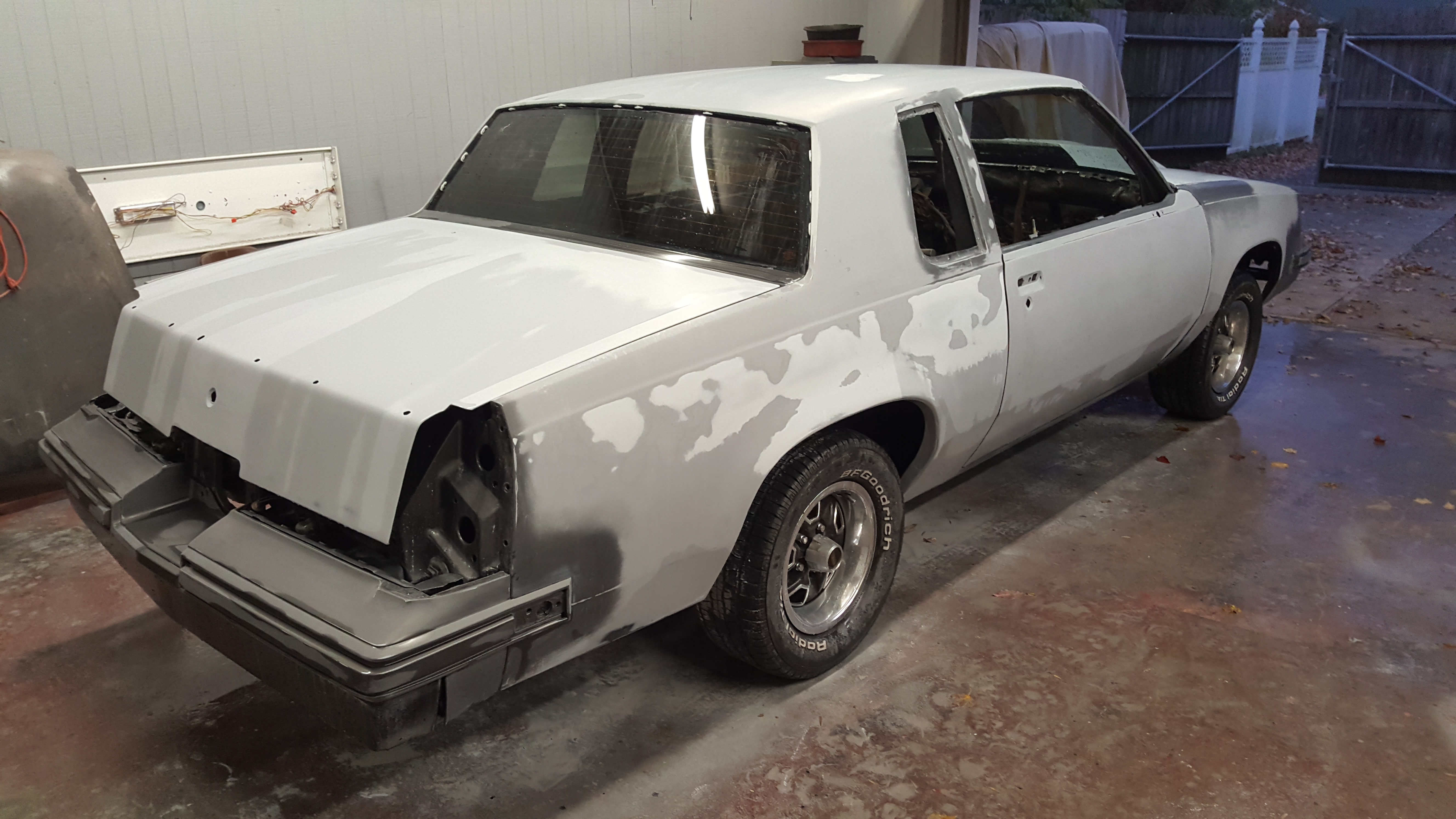

Well, it's been a long, exhausting day to say the least! After several more hours of wet sanding the car, I can finally say IT'S READY FOR PAINT!!!!!
I'm going to give it a once over tomorrow just to be sure, but as of now I'm 99% sure it's done! I will call the professional shop tomorrow to confirm the delivery of the Cutlass on Tuesday, and hopefully the next update will be of it getting dropped off for some shiney.
Anyways, here are a few pics....
Anyways, here are a few pics....View attachment 76542 View attachment 76543 View attachment 76544
