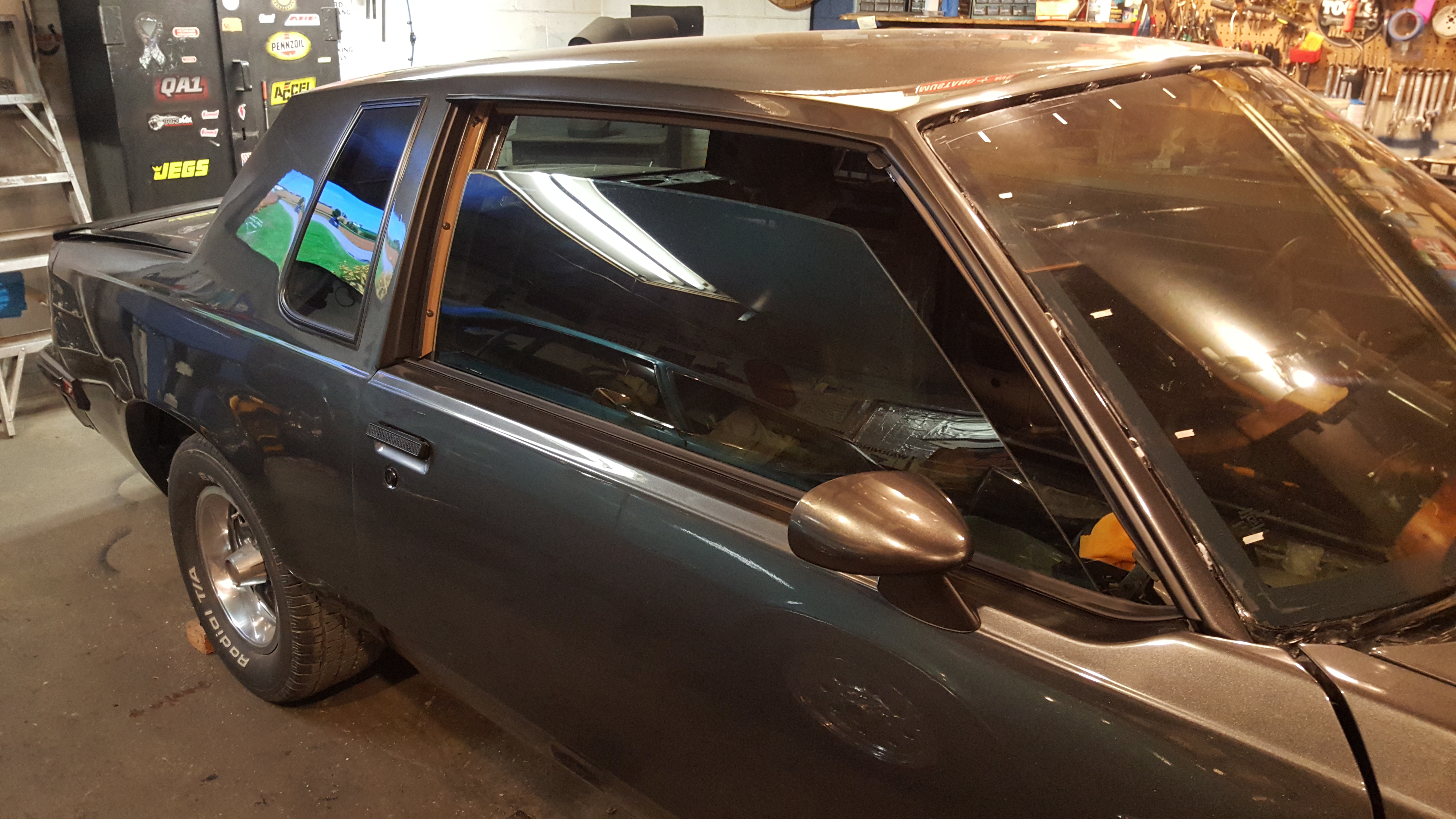

Small update guys. I had a couple hours to tinker with the Cutlass today, so I managed to dig out the door glass from safe storage and get them installed. Now I have to figure out to hotwire the window motors to raise the glass, but that'll be after the weatherstripping is on.
Anyways, I'm glad to have all the glass in finally and here are a couple pics....View attachment 84349 View attachment 84350
Those windows are just a power and ground on 2 terminals run 12 volts and they go if it goes the wrong way just reverse polarity for the other Direction I do it at work all the time with a booster pack and 2 picks
