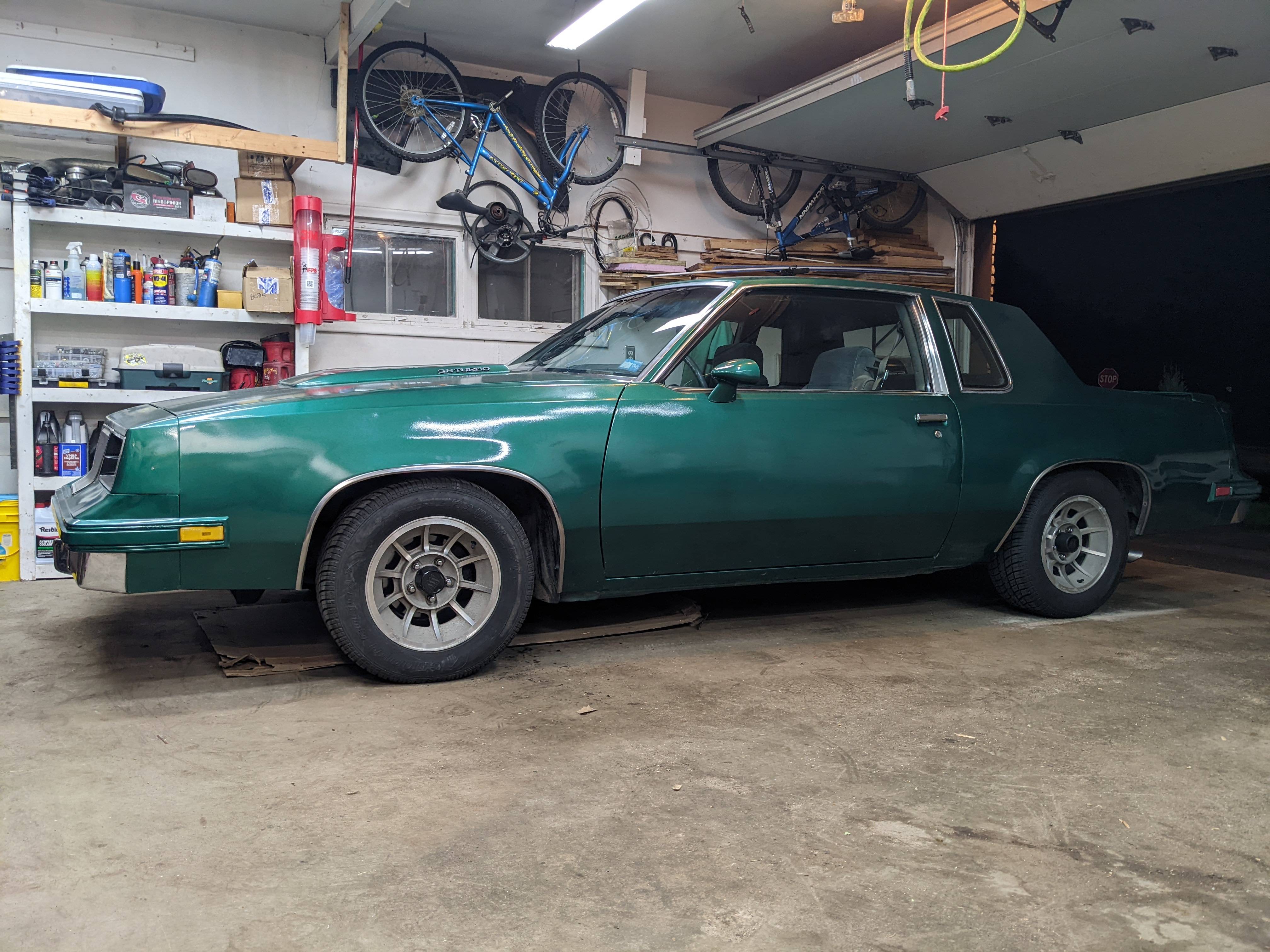

Take 2, no more Carolina squat. Cut another 1/4 coil (.650") and it settled right in at 26" after a short cruise.
Not motorhead Mike low but good enough for me 😛
I needs a front air dam but otherwise I'm happy with where it is!

It looks really good. It'll settle in a bit more.
EDIT: I had a post that didn't survive the server issues that told you to sneak up on it. Glad you did.

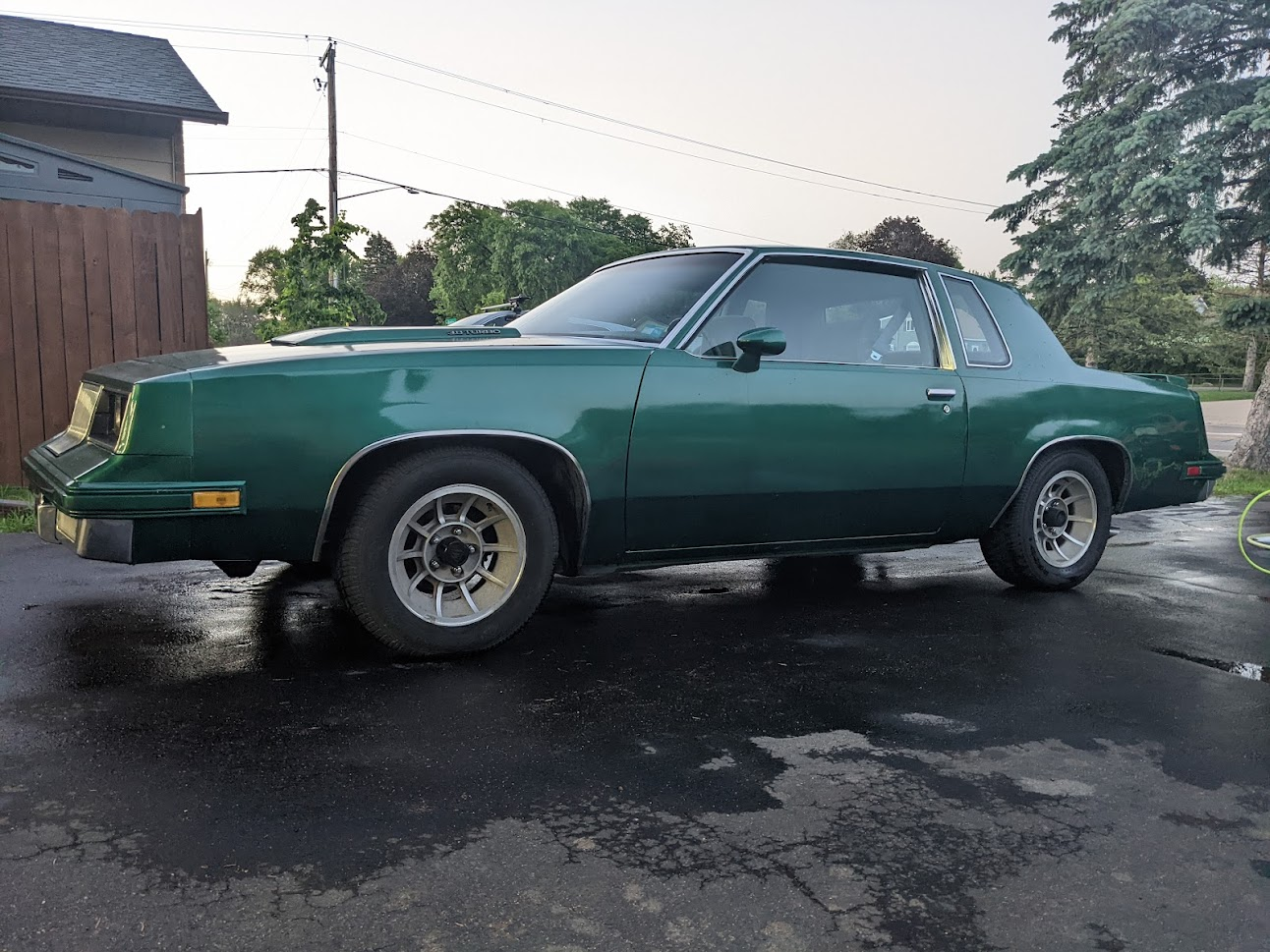

Braved the 'record heat' warning (Yeah, it's summer, it's warm, it's not that atypical, it's still better than January and -15f) and power washed the car last night along with washing the last of the mouse urine stains from the ~5 years it has sat in storage.
Very happy with where the ride height settled in at and the car rides better than it ever has. Ended up with Moog 5409 rears, and 5660's on the front with 3/4 coil cut on the front with 1/2 tall lower ball joints and zq8 foam bump stops up front. Otherwise just stock rebuild. It's comfortable but still confidence inspiring which is what I wanted. The steering parts were wasted when I rebuilt the setup last fall but getting a good gauge on everything was tough with the front ride height being too high and the rear still being stock.
It has 'woomped' over bumps from the rear end for 12 years and I'm 99% sure the monroe shocks on the back blew the day I put them on. I think the shocks were making funny noises on rebound and it never felt like the rear end was supported. That's fixed now. Only complaint is the brakes are so lame compared to the 2+2, but it's going to get LS1 disks up front and disks on the rear when I drop in the 8.5" rear so that's going to get addressed.
