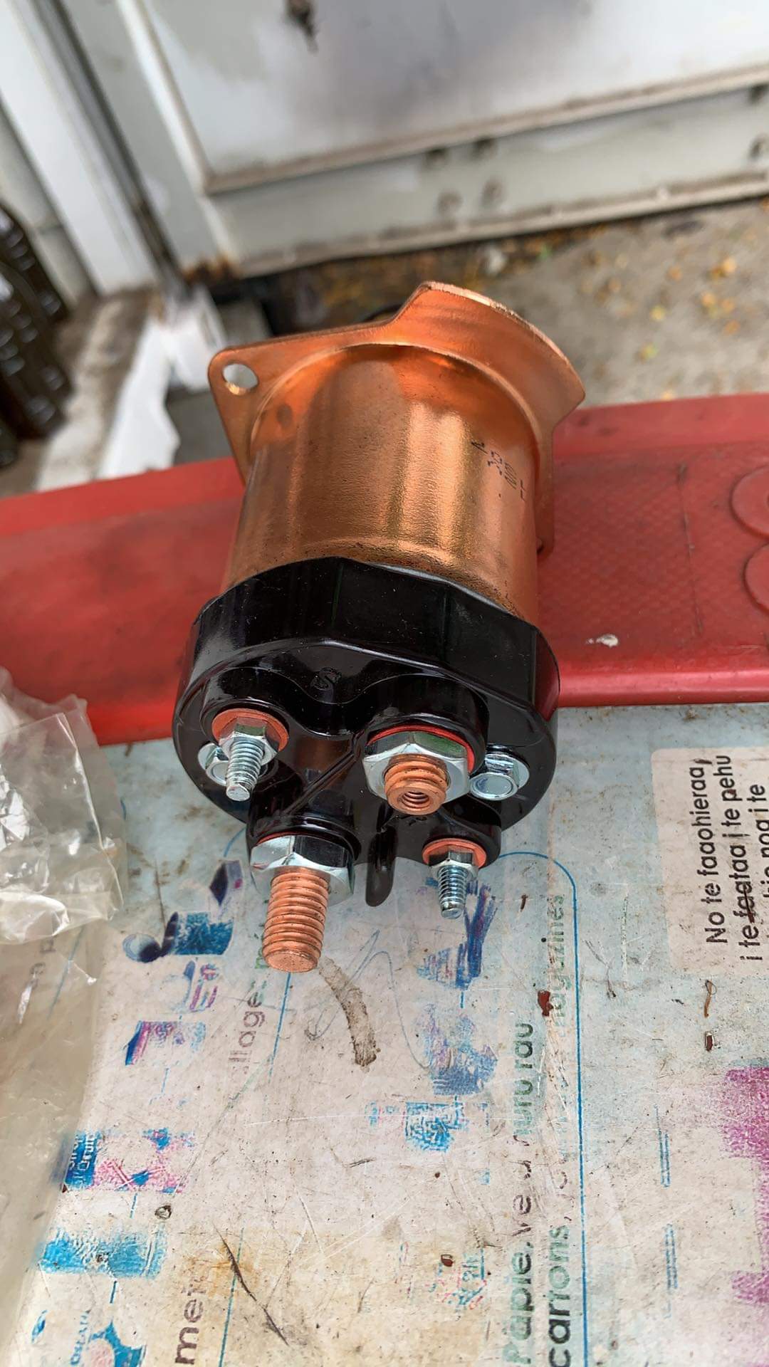

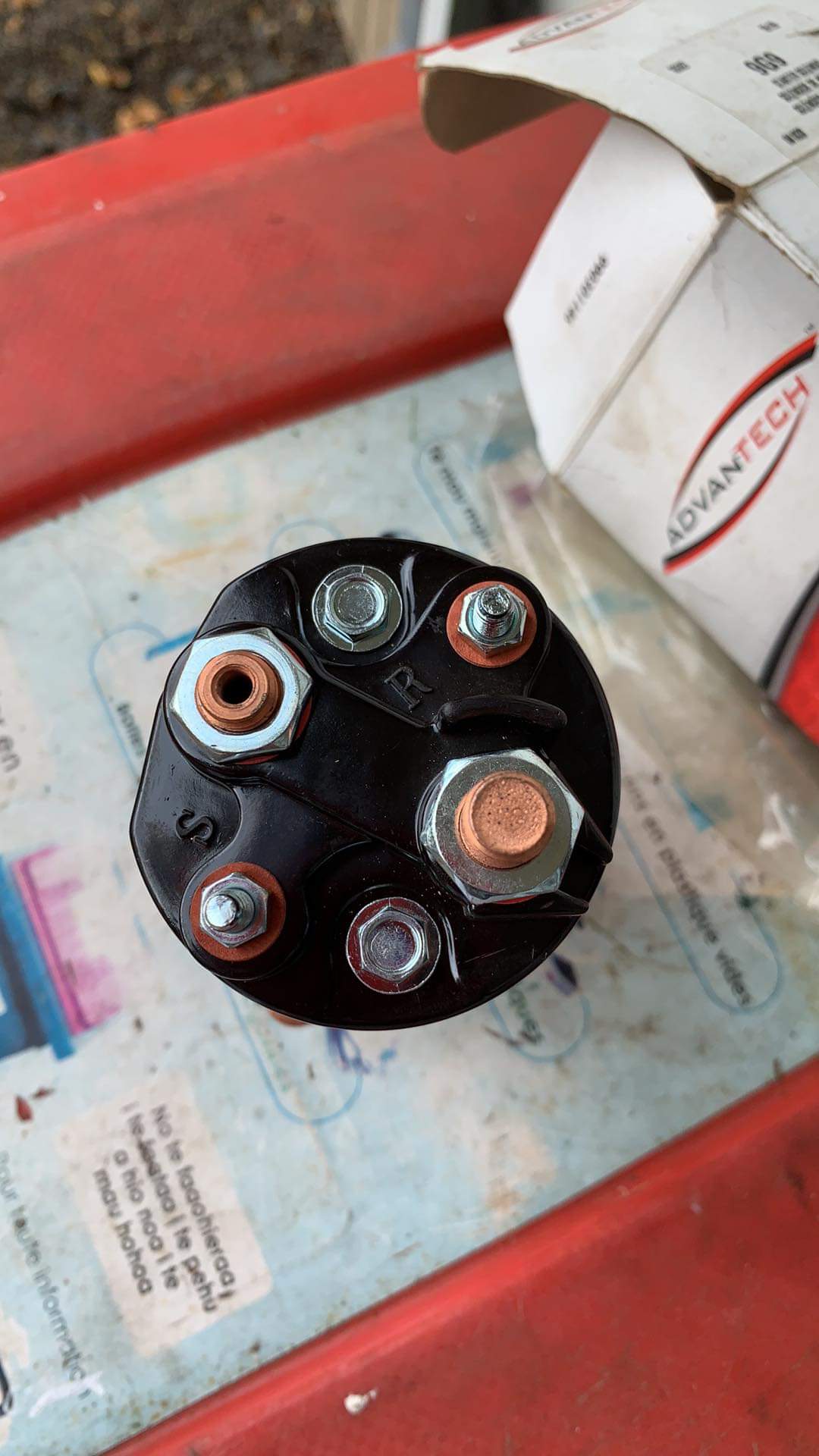

A solenoid : it looks pretty similar
View attachment 142805View attachment 142806

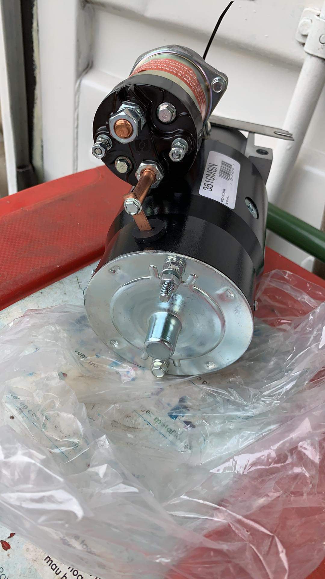

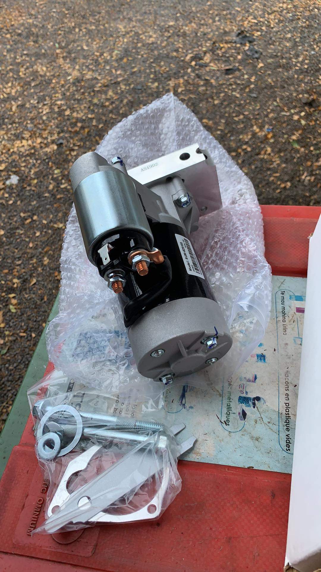

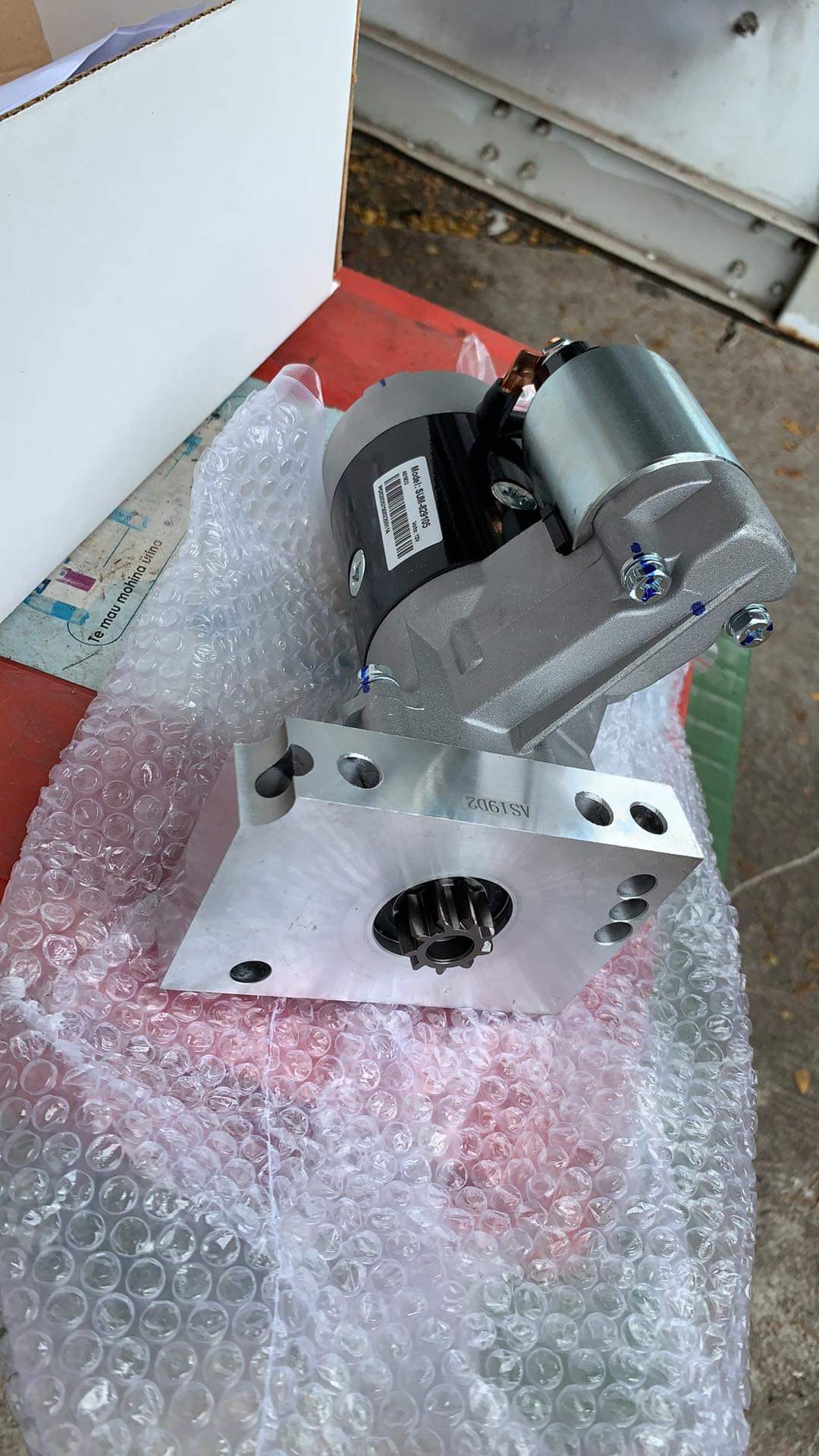

Or a starter for chevy 350
Or a high torque mini starter, is it this one compatible with oldsmobile v8?
View attachment 142808View attachment 142809
Are theses parts compatibles ??
What would you choose ??
Thanks a lot !!
That is the same mini starter that I have on my Cadillac 500 and it works like a charm. I believe that it fits your Olds, but i'm sure somebody with absolute info will chime in.
Get the solenoid to fix your original starter and have a spare if nothing else. Yes, that mini starter will work if it for a sbc.
