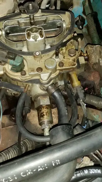

Well, finally replaced the fuel filter. Picture of the old included. It's running better, still not 100%. Also, Is the vacuum hose in the picture in the right spot? It's connecting from the bottom of the carburetor back to the top. I'll also include a picture.
