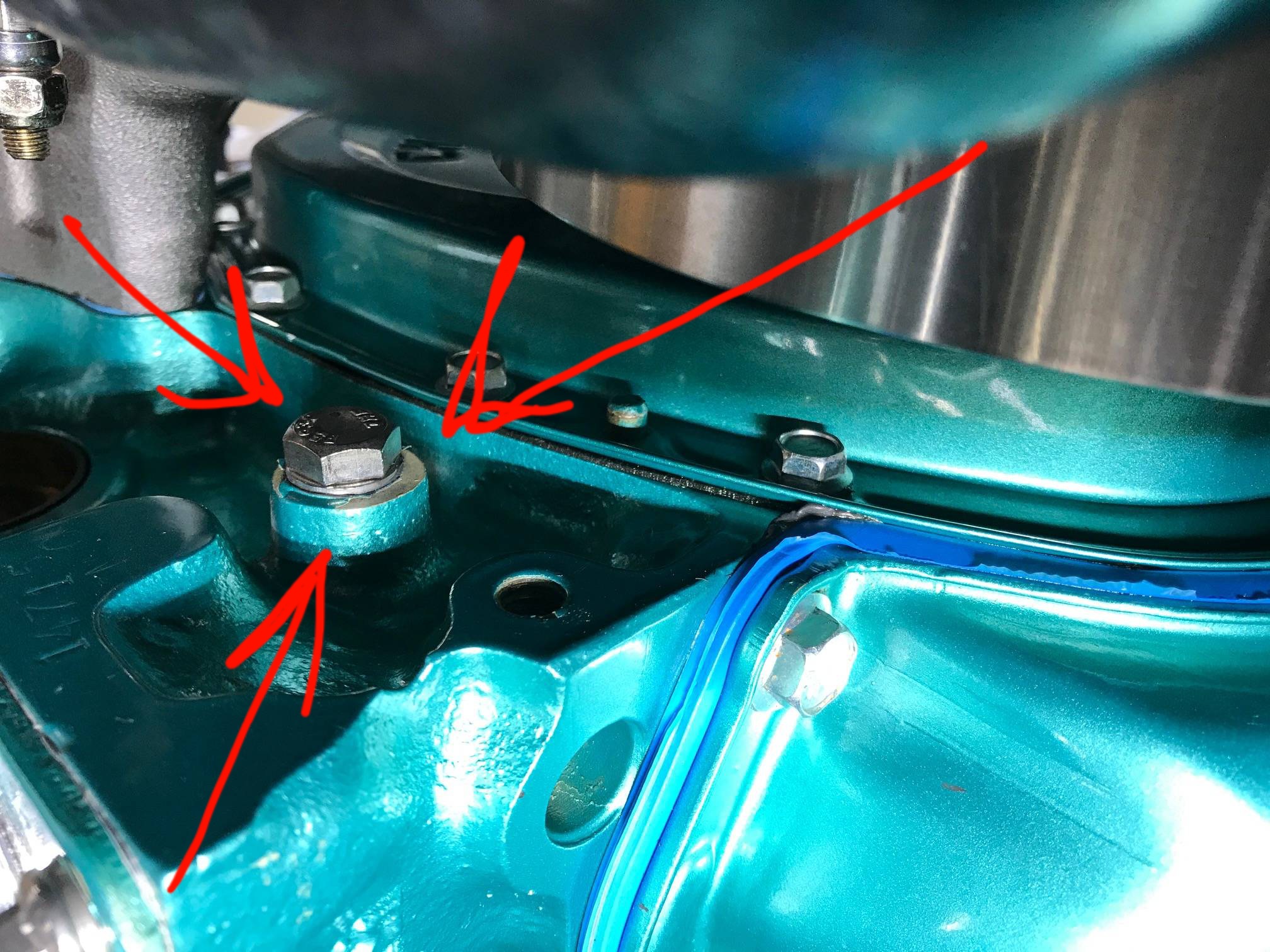

I know you mentioned the erratic idle first and the oil leak second. If the oil leak is your main concern, make sure you have a bolt plugging this hole first. Lots of timing covers have been replaced because oil was leaking from that bolt hole.View attachment 191009
Nope, the bolts got sealer on the threads. Look at the gasket. Then look at the pin. I primed the block with Dupont Variprime and sprayed it with acrylic enamel. Never cleaned the pins. When I put the cover on it was tight on the pin. Figured the bolts would suck it down to the block. It didnt. It tweaked the cover just enough to not compress the gasket and cause a nasty leak. It was dripping out of there pretty good. Enough to puddle under the car in a few minutes of run time.
I had two options after I take it out. Use that cover, try to get it flat again and use more sealer with a new gasket or do the same with a new cover. I spent a few bucks, bought a new cover and its painted sitting on a shelf waiting to go back on.
The cover on the wagon was tweaked even more. Guess I should havebeen paying way more attention when I was putting it on. Live and learn. Thats what happens when you do something as a hobby and not a living. LOL

Uhmm.... I think he was referring to the OP's issues (erratic idle & oil leak) & using your image to show where a watch-out is? That's how I read it.

The leak in the pics a couple of pages back is doubtfully going to be resolved by a a front cover gasket/seal replacement. Perhaps a cover, gasket and seal replacement, but I'll guess something else is leaking or the front cover is broke.
Yeah, I was talking about OP's leak. I just used his photo because it was a good example of having the bolt plugging the leak. His clean paint and good lighting made it easy to spot.

Dang guys, I thought you directed the comment to me. Sorry about that ! Should have realized that when I saw the idle comment. LOL
