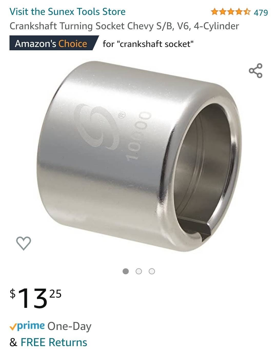

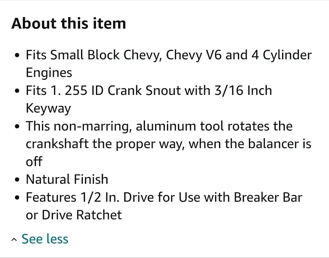

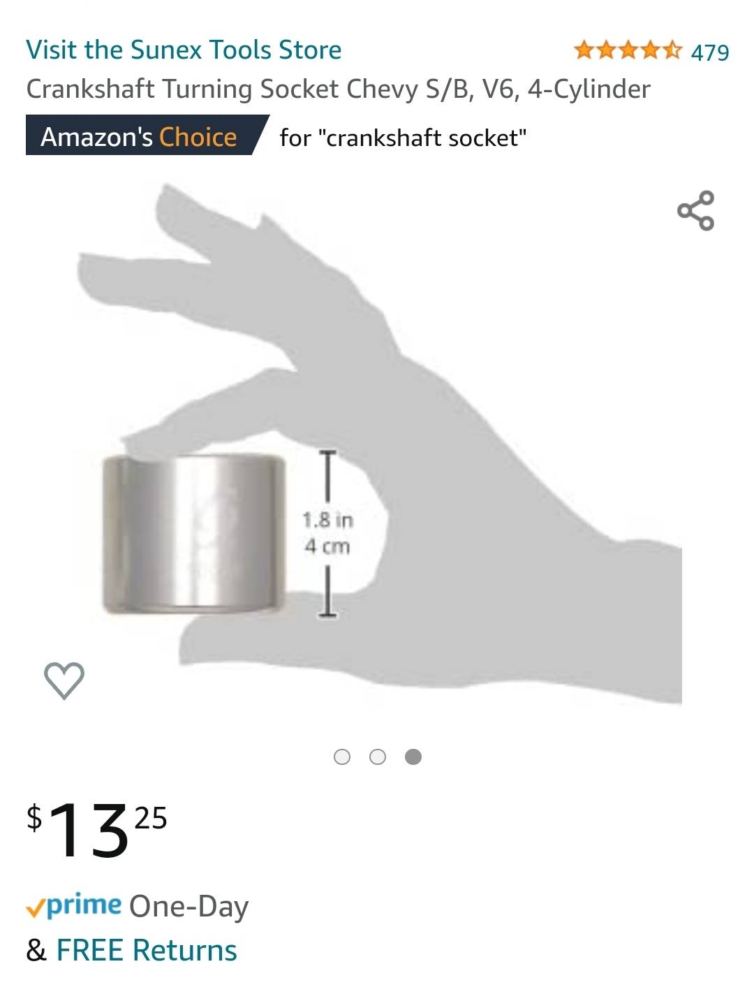

Besides fixing this timing cover leak, my goal is to also inspect the timing marks on TDC and the timing chain to insure the root of my engine timing is accurate inside the engine, eliminating the timing gears and chain causing my timing set troubles...
Is this the right size crankshaft socket I'll need to turn the crankshaft after the crankshaft pully and harmonic balancer are removed ?

Before I get started, I need to make sure I have the right tools for the job before I start taking things apart.
I would borrow the tools from your relatives that have "the tools you need to do anything" or use the "loan a tool program" and see what is available from Autozone or some other place, I feel these tools are only going to be a one time use thing for you so buying them is just wasting money if there are other options to get them that don't cost anything.
