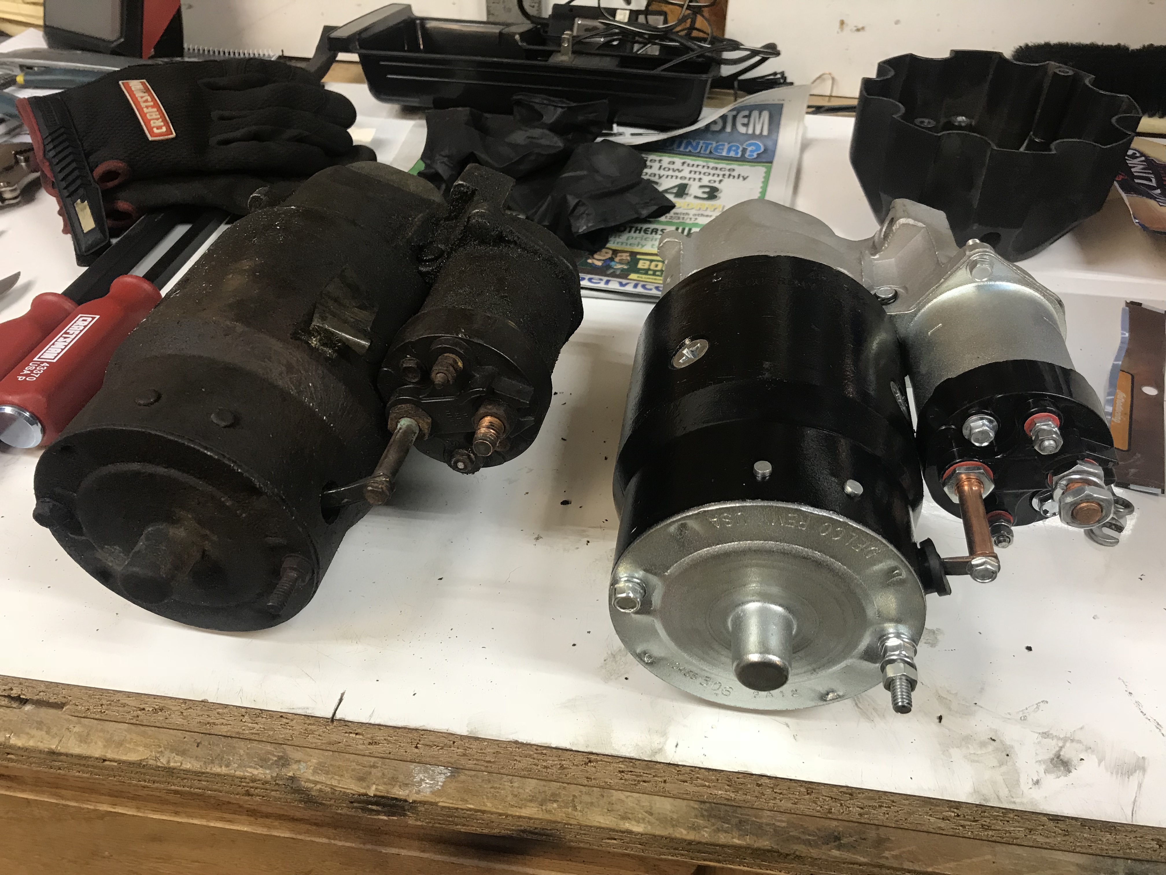

Put in a new starter, the old one would freeze up like every 3 times I went to start the car and I'd have to beat it with a tire iron to get it to turn over. The old one was also caked in an inch of oil and grease haha
Consider pulling apart the old starter and maybe rebuilding it. Can't hurt to have a spare. I don't remember how much the parts to rebuild one are, but it's gotta be cheaper than a new one. Plus never hurts to learn a new skill.

$50 for a re=man with a limited lifetime warranty or $37 with a 1 year warranty... if you did a rebuild right, it'd cost more in parts and having a shop test the armature..... I like the way you think though, learn a dying skill, you never know when it'll save your butt in a pinch!
