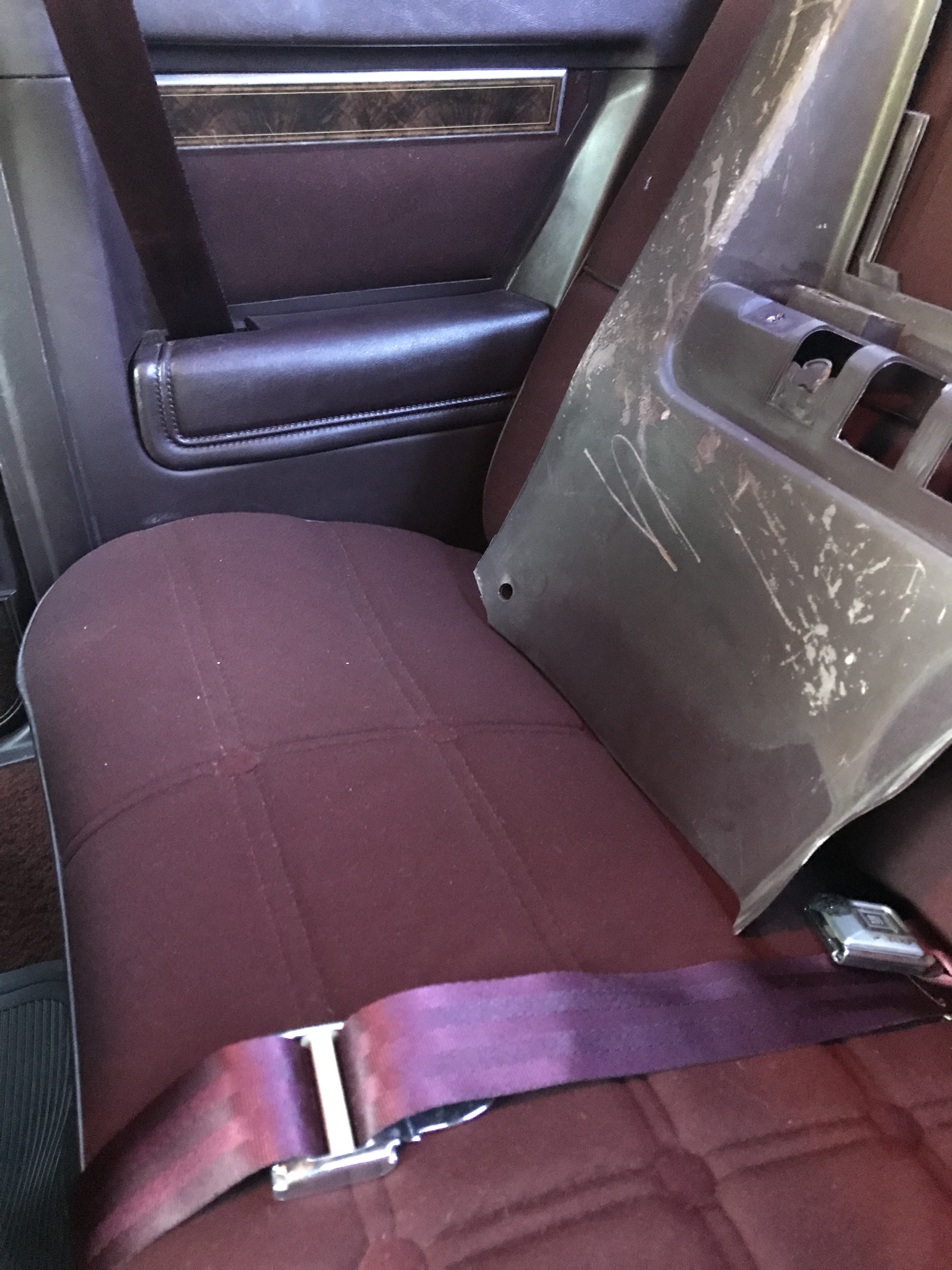

Replaced the two rear lower sail panels with some nice ones I picked up . Needed to remove the entire back seat and disconnect the seat belts so they could be threaded through the new panels . Luckily everything came apart nicely with no rusted or frozen bolts . Overall about a two hour job
View attachment 121926Replaced the two rear lower sail panels with some nice ones I picked up . Needed to remove the entire back seat and disconnect the seat belts so they could be threaded through the new panels . Luckily everything came apart nicely with no rusted or frozen bolts . Overall about a two hour job
Now just scuff and spray SEM color match paint and you will have another set that look good
