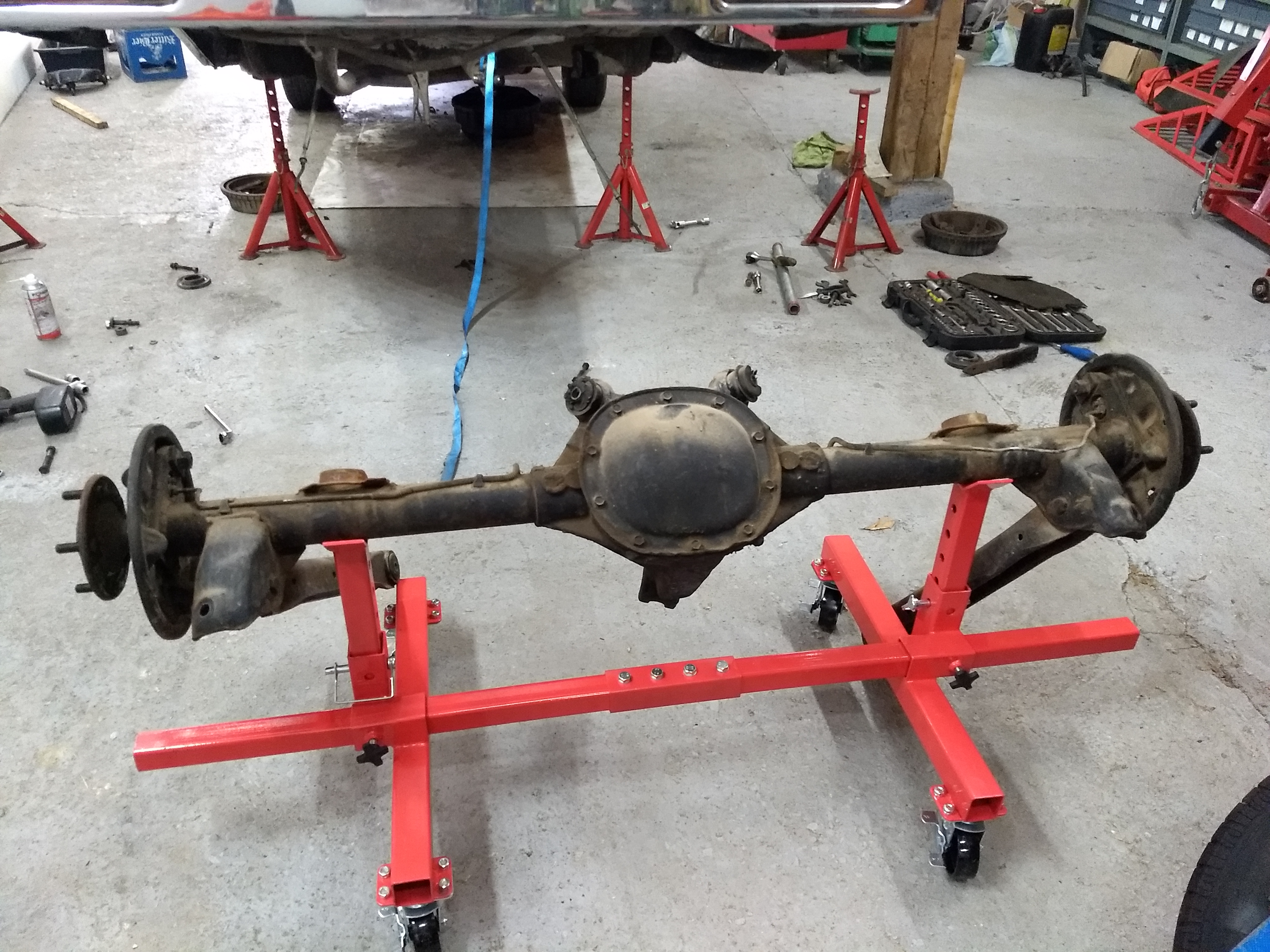

Rear end time today. I'm still debating to get rid of the anemic 2.41 one legger in favour to a 3.42 true trac.
