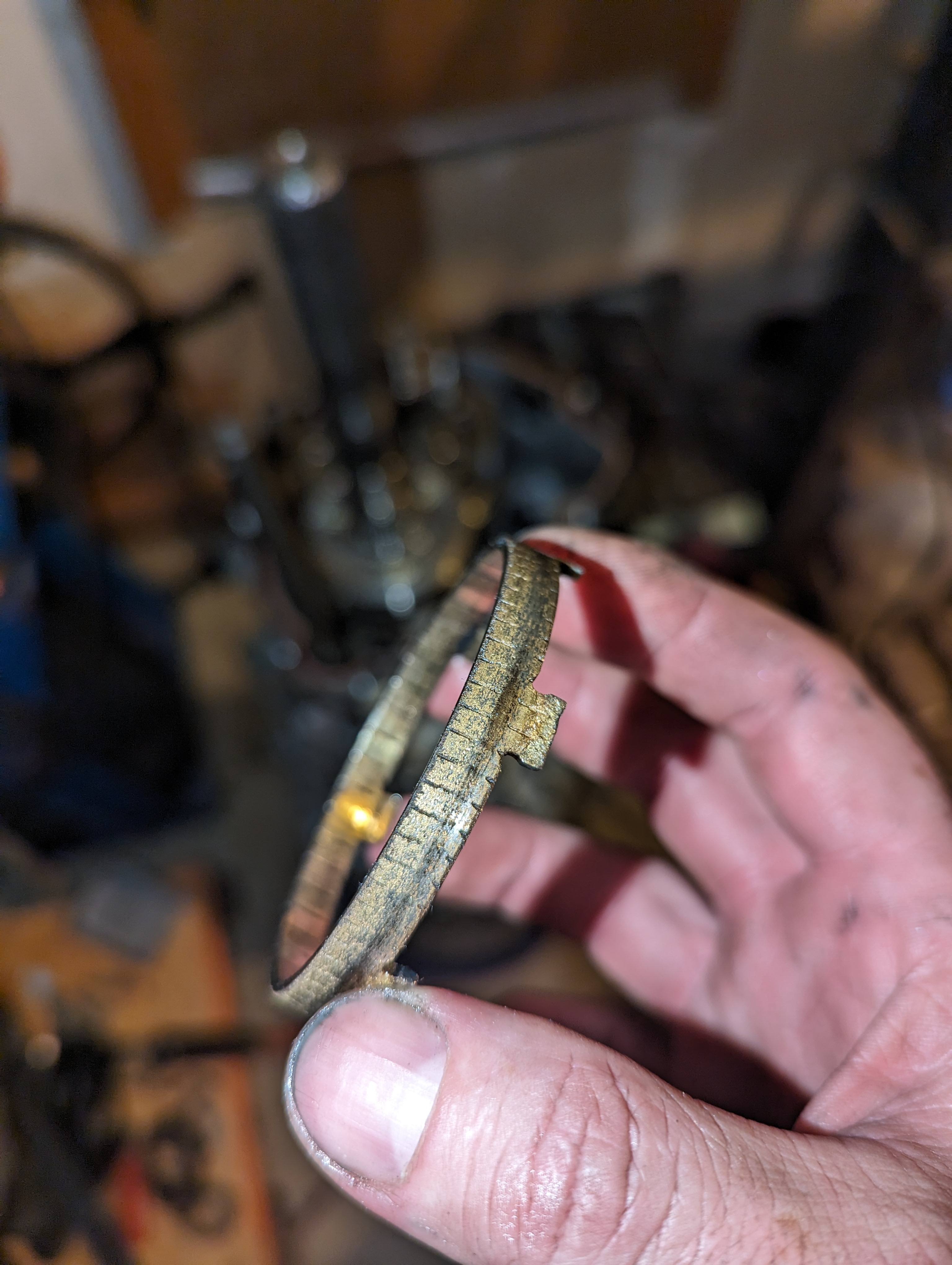

So the Camaro has a T56 Magnum in it and reverse crapped out today. I now see why.
Hmm, seems like there should be stuff here?
There's some stuff. But where's the rest of it?
Someone owes that magnet a beer. But wait, there's more!
Turns out this thing had a double cone reverse syncro. Not anymore. I'll need to be aggressive with shipping to get this shjt here in time for the weekend. The spare transmission for this has different gearing and this Magnum had a 32 spline output so my overwhelming preference is to get this lump whole again and reinstalled.
That looks like the input shaft bearing after my dad "borrowed" my '72 Monte back in the '90's. Goofy old b*st*rd was trying to show off to some girls too young for him by dumping the clutch for a one wheel peel. Didn't even bother to tell me when I got back into town, just let me find out the hard way. It's fun magnet fishing in your transmission.
Got sucked into helping at a craft show instead of being at Cars N Coffee since my ex talked my sister into doing her first craft show. Ended up missing out on a good turnout at CnC, apparently Stradmans old Ferarri was purchased by someone local and then they went to Twin Peaks after just to rub it in haha
Reactions: 79CutlassSupreme
So the gear is what let go.
Those are 2 separate pieces laser welded together. I overnighted a reverse gear, syncro assembly, and speedo reluctor as I cracked that removing it. Oh what fun that was finding. When you look up 6060/Magnum reluctor all you find is 12 tooth or 40 tooth and they have a relief cut out for a ball to sit in and locate the thing. This just presses onto a smooth part of the main shaft and has 17 teeth. After calling like 19 shops/dealers and Tremec themselves I came to realize this same reluctor was used by GM in the CTSV and GTO (and likely the SSR). This trans is a Magnum F, so a little different than a regular magnum. I had no idea that was a thing until today. Thegearbox.org had it all on the shelf so that's who got the money. Hopefully I can get this buttoned up in the next day or 2 so my beloved Corvette can park inside again.
