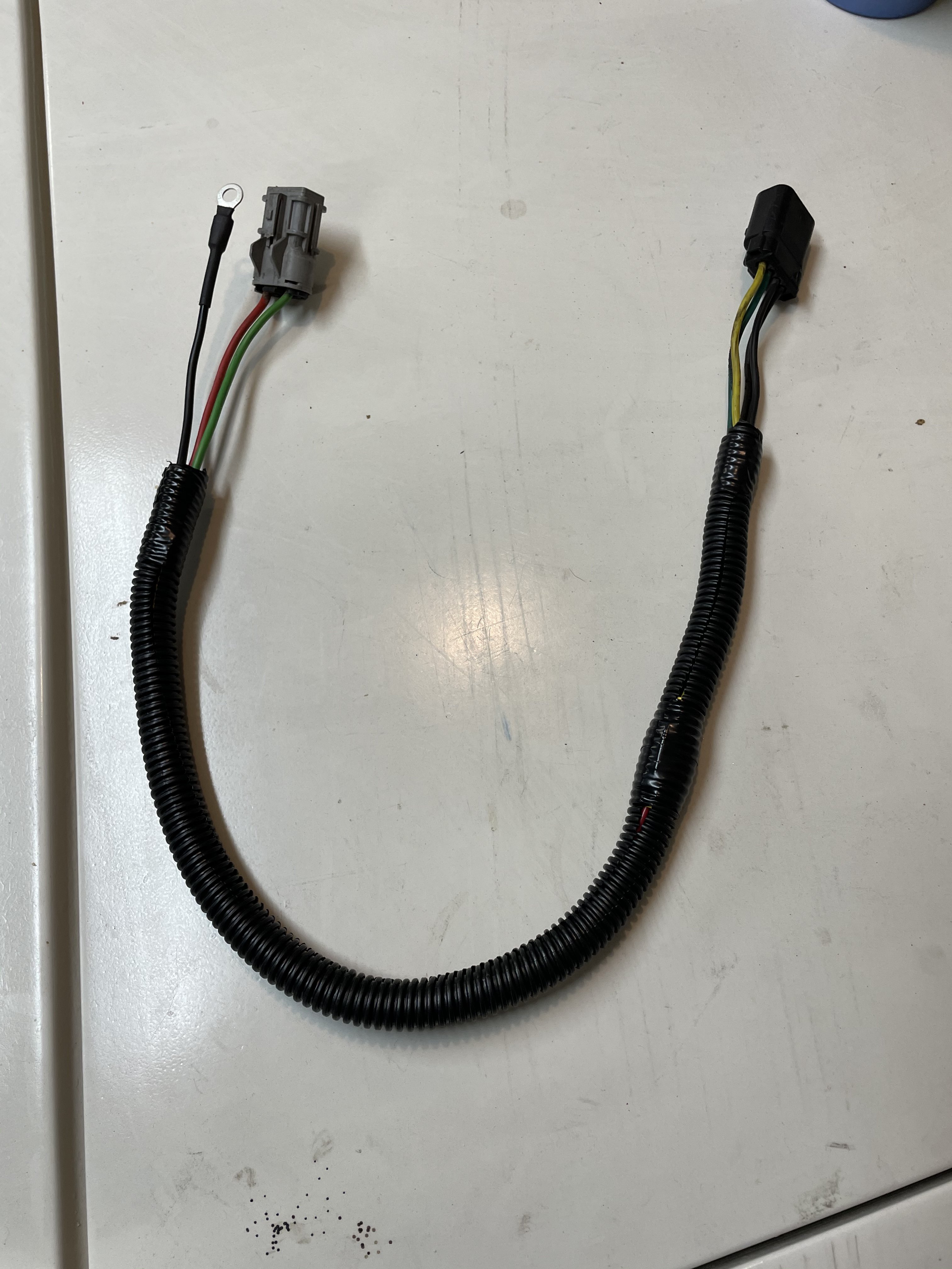

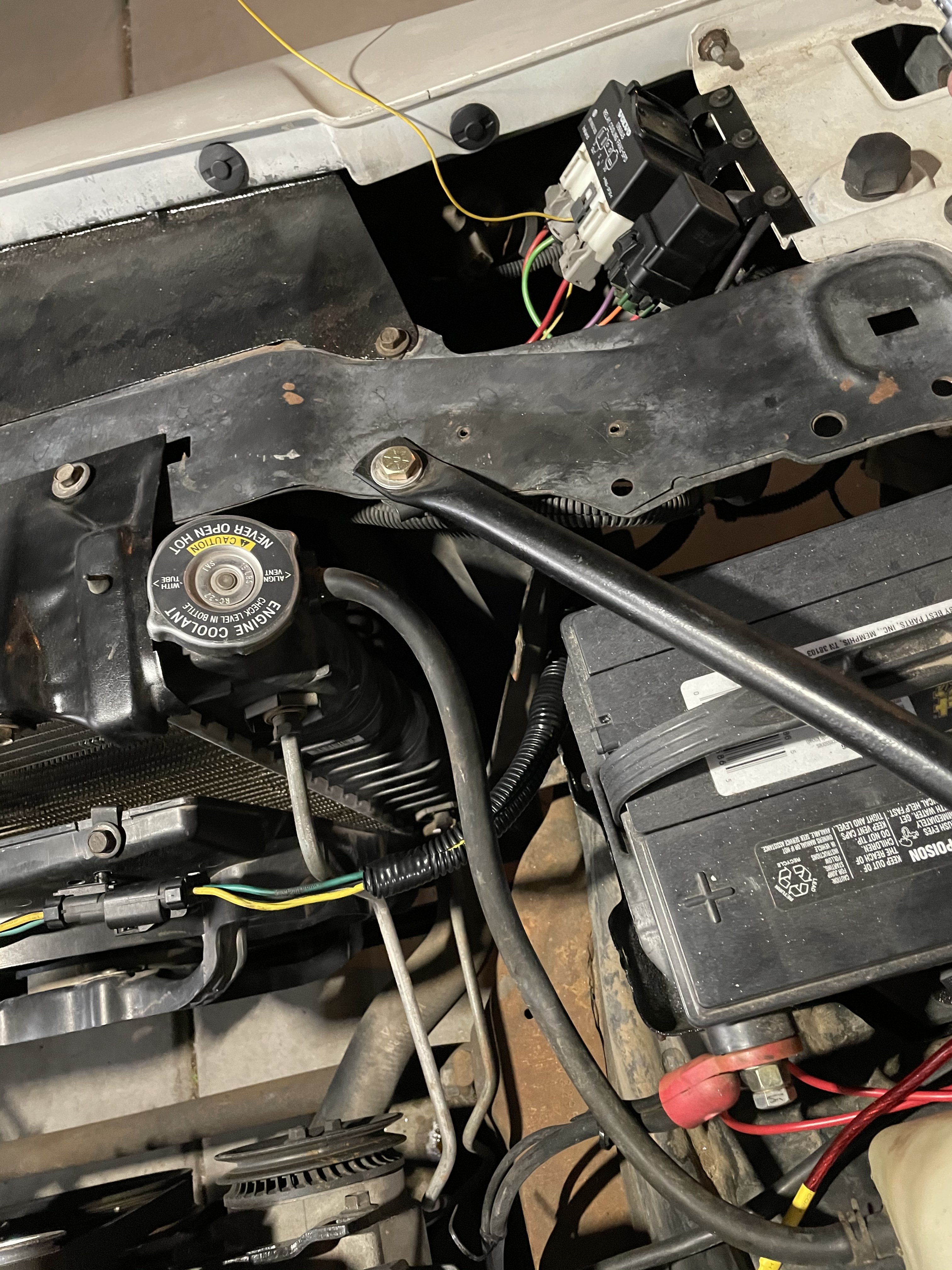

Installed electric fans. It’s been a long time coming! Little by little, piece by piece. I’d like to thank Scott for the advice and photos and above all else the words of wisdom - “keep it simple!”
Did up some simple brackets to help it attach to the top plate. Still need to secure the bottom. Ran a line to my fuse box under the dash for the switched/ignition trigger so that they don’t run when the car is off. Otherwise whatcha see is whatcha get. Very happy with the results and progress. Still need to get a temp sensor to finish it all completely but for now it’s in and has been tested in the garage.
For those looking to do the same: I used a fan from a circa 2001 Chrysler 300M but there are plenty of options. I used the Volvo fan relay setup but triggered with a separate relay so that it won’t run when the car is off. Here’s a little note I made while getting it all squared away. Feel free to ask any questions, I’m happy to help anyone else as much as I can.
