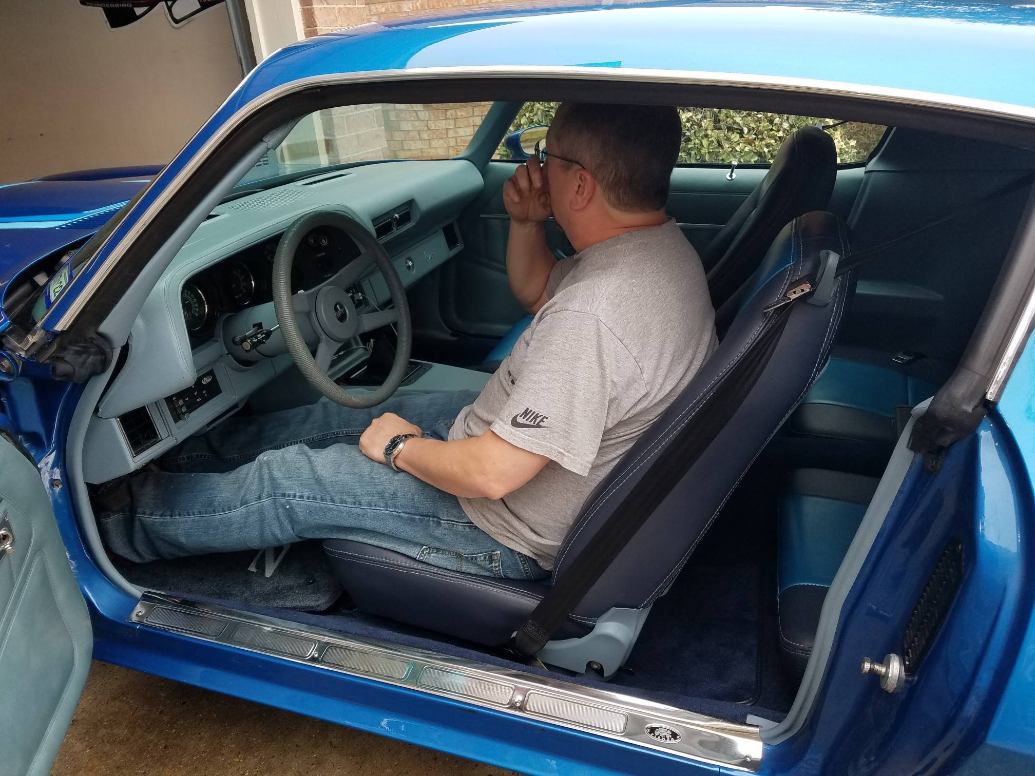

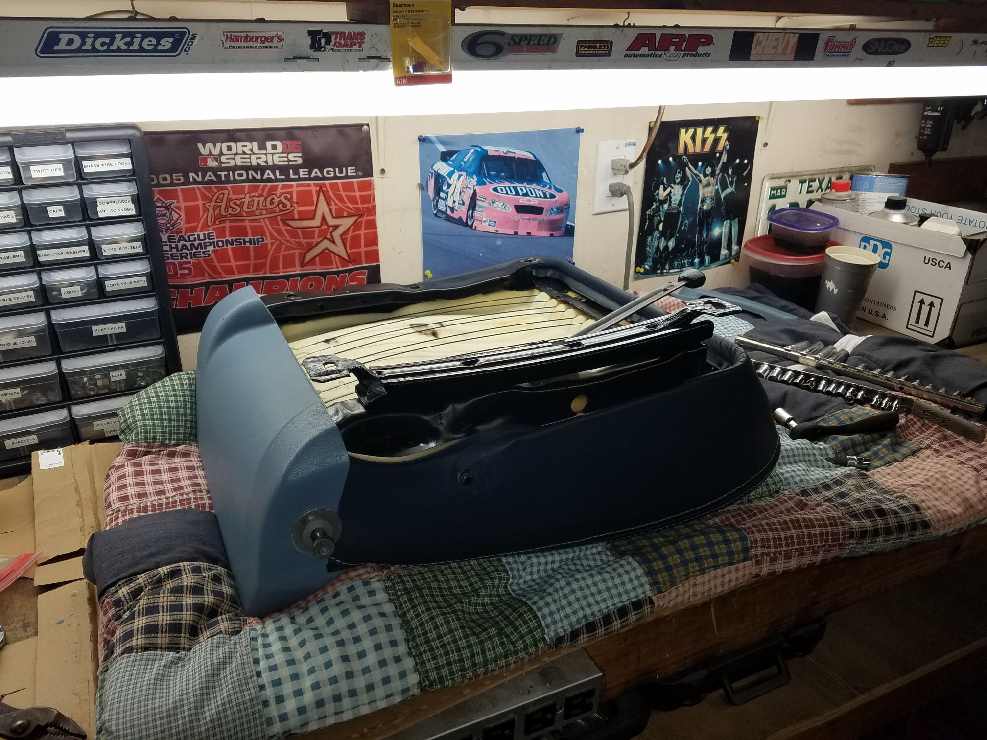

Sean and I got the Driver's side seat for the Camaro back together on Saturday. I didn't take a lot of pictures. First, we replaced the hog rings we'd previously removed. That took a little for us to get the hang of. We'd never done it before. Next we put the lower trim on and I took the first pic...

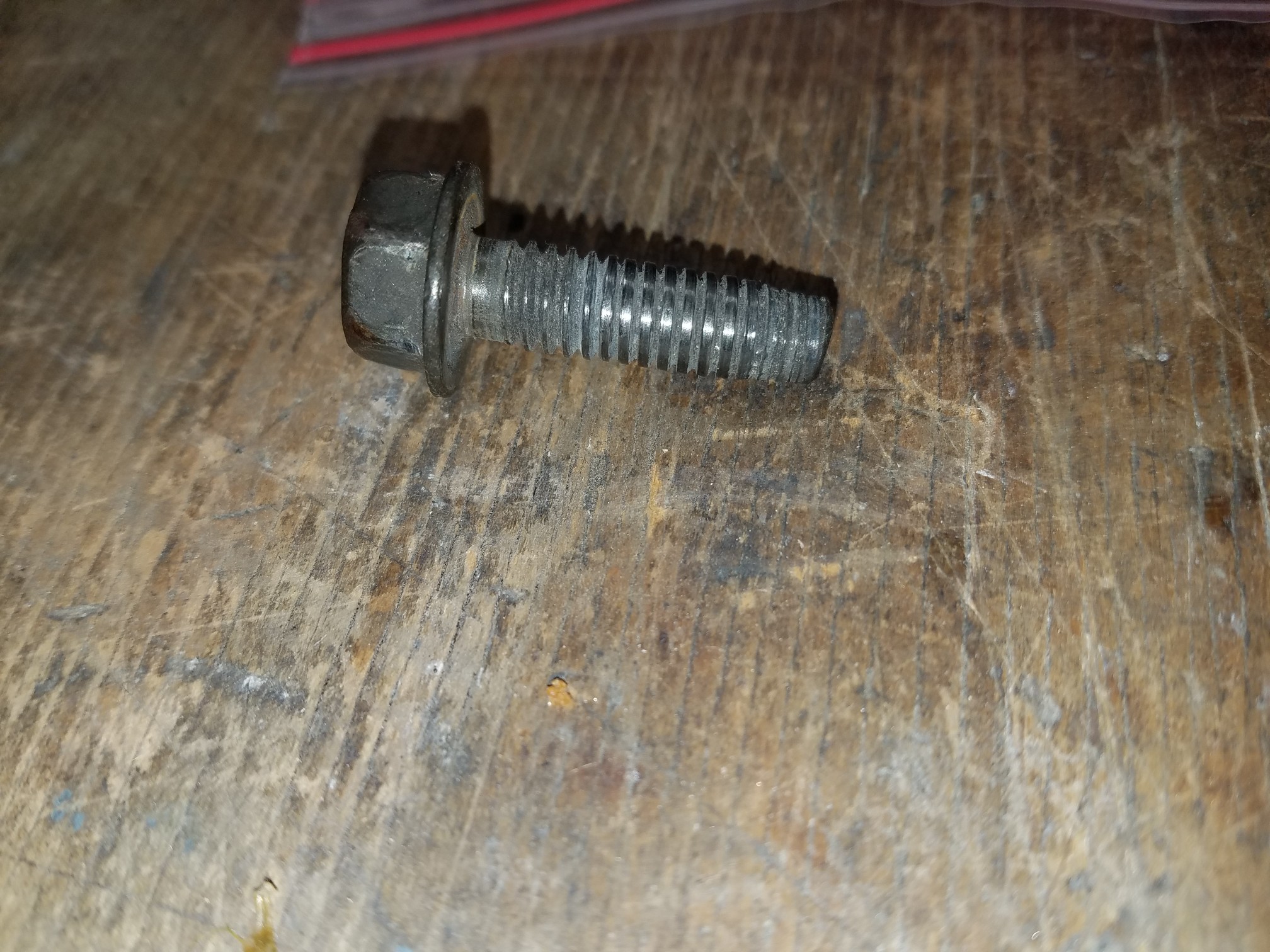

Next we started getting the tracks back on it. One of the bolts didn't look too hot...

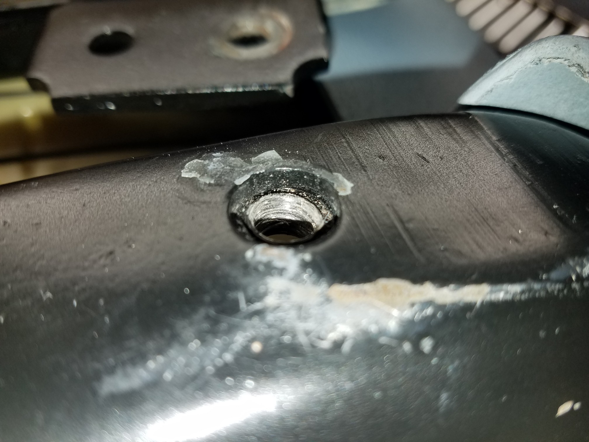

I don't remember it coming apart badly but the corresponding bolt hole in the frame didn't look good either...
We quickly found a good replacement bolt in the "seats and seat belts" box (exact match) on the shelf but we had to go to the storage for the thread chasers. I'm REAAALLY looking forward to having all our tools in one place.
We got the tracks installed and lubed them with a little spray white lithium grease, put on the seat back and then the hinge trim...
Back in service...
Sunday morning we got the car out and gave it a wash. My sister-in-law snapped a pic as we got done....
Back on the road!
I feel like the only good way to ops check that seat is with a massive burnout directly in front of your house to ensure the safety and security of the driver.

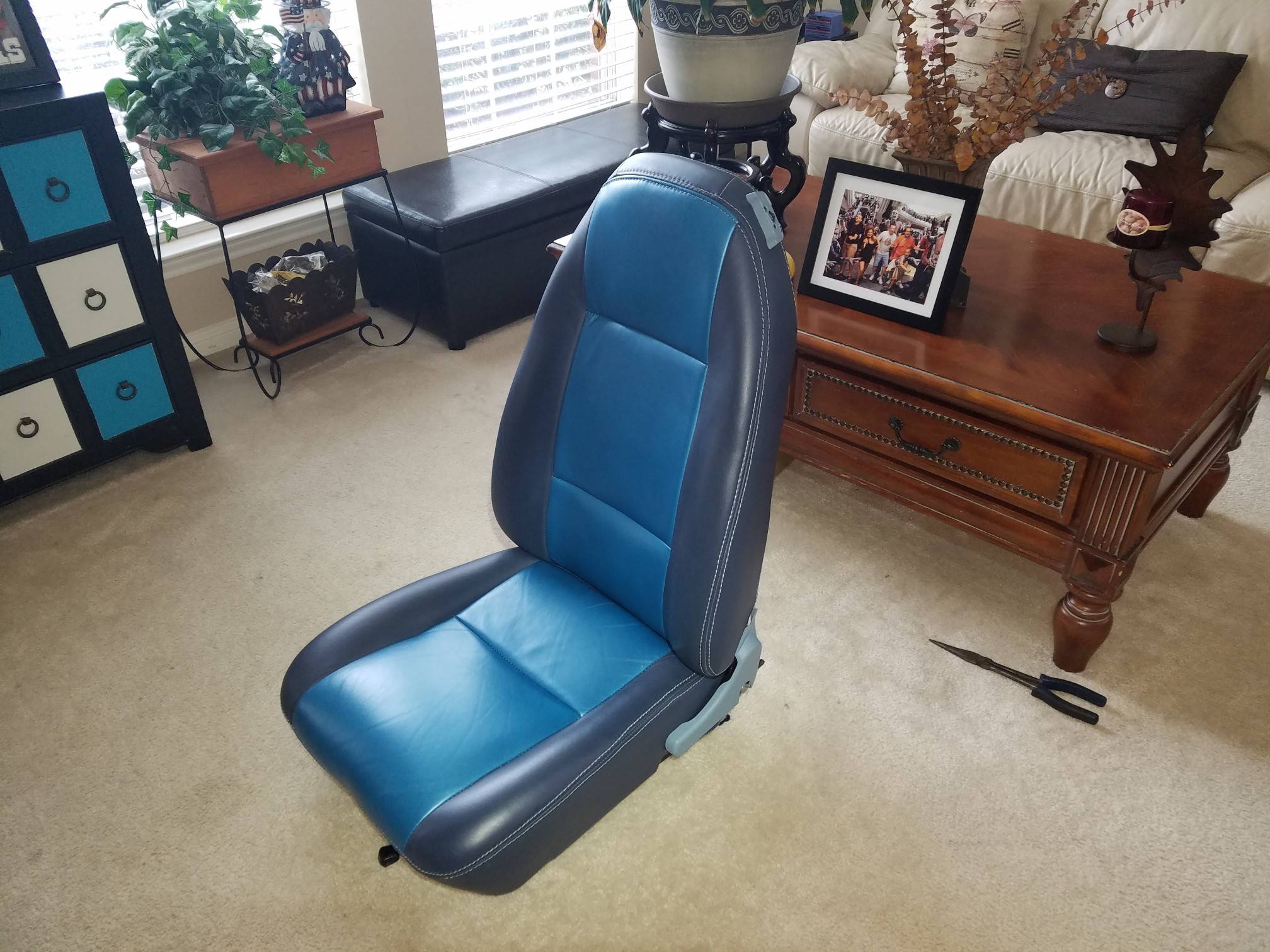

Last month we had to do some work on the passenger seat. It looked like we had a similar seat bun spring failure, but on both sides of the seat. I was working on the exhaust on my truck so Sean took the lead and pulled the seat....

We took the same repair approach. Bend the spring down and inward away from the seat cover, then glue a section of denim over the damaged foam....
Put it back together...
Back in service....
